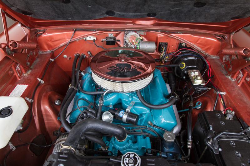

My 383 is for from stock..This is how it looks. The air cleaner I run on the street. My stock one goes on for shows. I am running CPPA Streetfighter Alloy heads, Edelbrock Performer RPM, 750 Holley.

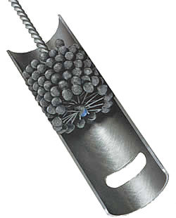

I'm considering honing my stock HP exhaust manifolds this winter. If you youtube "Flex Hone Exhaust", do not follow what the guy demonstrating does. I'm absolutely positive you want to use these hones with some type of lubricant.

That's very nice, TekHousE!
