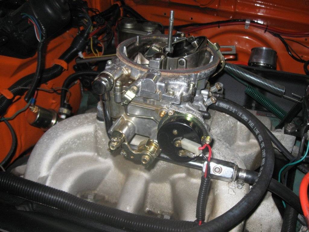

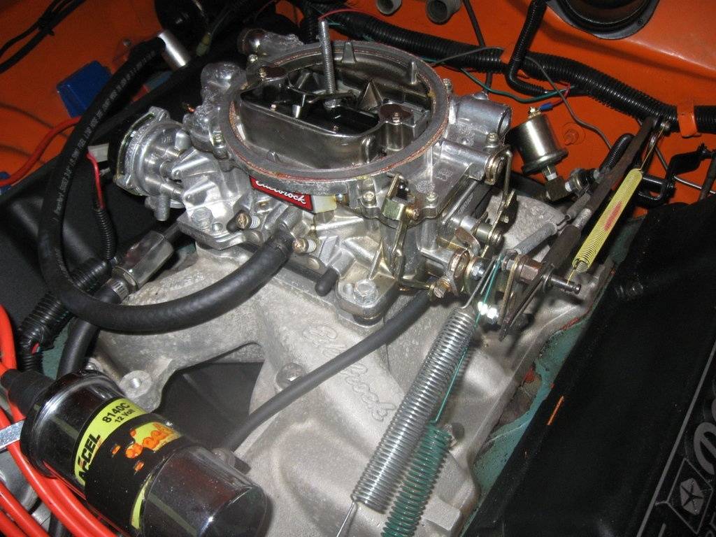

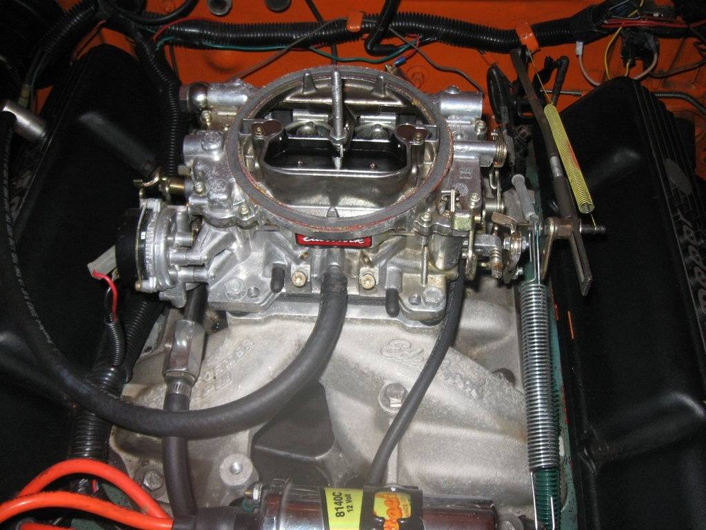

The accelerator pump function looks good. I was wondering if I need a carb with vacuum secondarys ? My car is an automatic and I read that mechanical secondary does not work so well with automatic ??? . The carb is fairly new but the metering rods were changed because my mechanic seemed to believe it was to lean. I'm not sure about what cam the engine has, I bought the car with this set-up. What carb and cam are you guys using? I believe it is a fuel problem but I just don't know where to start. I hate to just start throwing parts at it and hoping for the best but this engine should really launch this car. Thanks for any help
Like ranger I too have the same set up; 383 auto.
I used a vacuum gauge to set up at idle. Best I could get was 11.5 inches. It runs great, but slightly rich. Once I address other issues I might play around with jets.
What are your timing specs also?
You kinda have a vacuum secondary already a true double pumper/mechanical secondary would have another acc.pump on the rear side like a Holley. Probably just need some more tweaking on current setup.
I had an issue with my carb & it turned out to be the metering rod springs. The engine would surge at a steady speed & under a light load. The tuner said that vacuum was making the metering rods flutter & the next heavier spring solved my problem.
your carb is a 750 cfm,if you didnt know.might be a good idea to take the top off and see if there is a bunch of dirt in it.they pull apart pretty easy and does no gasket damage.try spraying it clean and retry it.could need a rebuild kit.lots of small pasages can get plugged if carb sat for a while.
