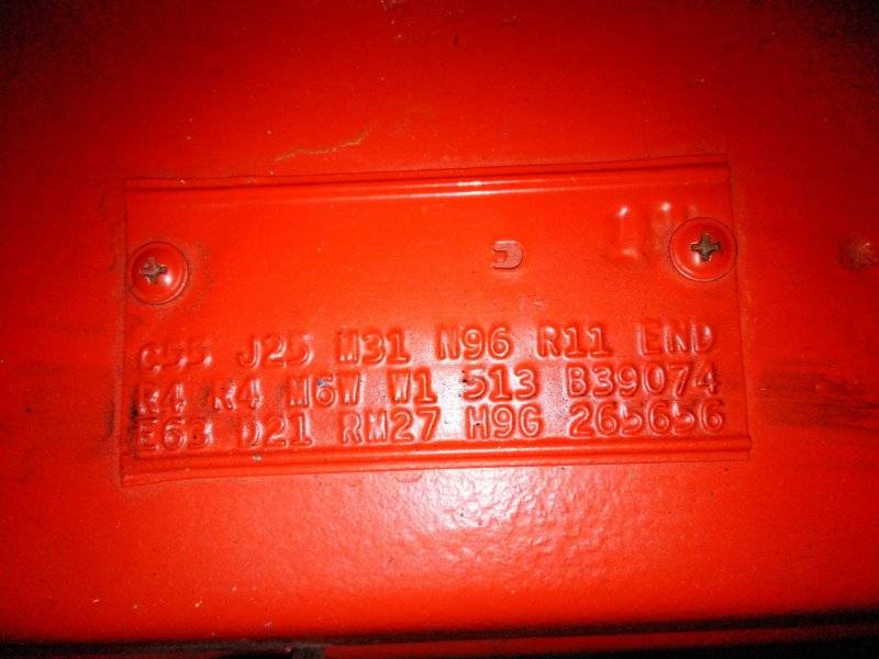

If you have a fender tag, you can find the "upper door frame" paint code there. It can be found on the second row from the bottom, usually, the 4th code from the left. If your car is/was originally white, it's likely coded W1 or EW1 - which is an exterior paint color. So, it's likely the vinyl and plastic parts were/are not the exact same shade.
ahh
thanks
Will check

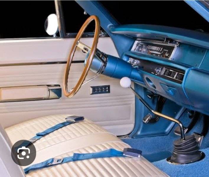

I did an internet search and found this picture from Hot Rod magazine. It looks like the door panels, arm rests and seats are a creamier white than the upper door panel white.

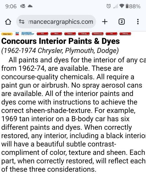

Here's an article from Performance Car Graphics explaining interior color variations
