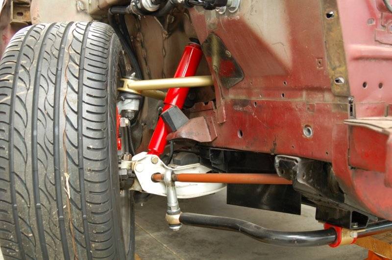

Any recommendations for aftermarket upper control arms 69 Road Runner
I gotta ask what makes these better than the factory ones?
I use Firm Feel upper arms on my stuff.
i used firm feel . make sure you use good rubber lubricant on those bushing when you install them , those urathane tend to get squeaky
and also glue or use silicone to keep the boot stuck to the ball joint. so when you grease them they dot pop off
Good tips thank you
