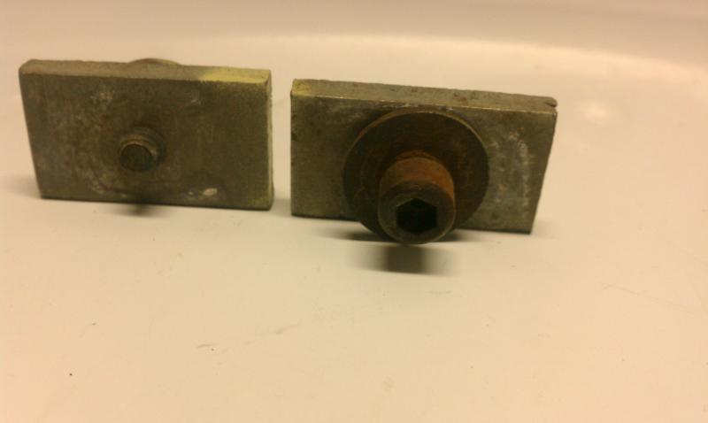

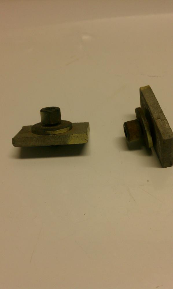

Does anybody have a picture of a wing window screw ? This is the screw that you tighten through the little hole on the upper inside of the doors. I lost mine or misplaced them.
Thanks
I'm at that step of my restoration. Mine is an allen head bolt with a tapped block. The bolt is maybe a #10 by 1 inch long and the block is about a 1/4 inch thick and 3/4 by 1. Maybe this helps. If not I will snap a shot of them tomorrow. Now my question is what if anything plugs the hole?
There is a very small plastic plug that goes in that hole reminds you of a bic pen plug. I have some originals PM me if interested
I think I have them.... check my pics and confirm... It makes sense looking at them.
Thanks,
Dave

Nice... I was getting pissed I couldn't find them. You know how it goes when your project spans years and years... I bagged em and lost em.... couldn't remember what they looked like. I remembered seeing these, but thought they went to my convertible top well mounts.
Thanks again !
Dave
