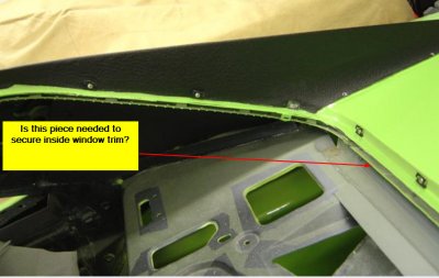

Making sure I have everything, what is this piece for? To secure the interior molding trim?
And how is the rear package trey secured?

I'm at a loss at to what piece you are referring to, just the sheet metal edge? Yes there is a plastic trim piece that basically covers that up, it's attached to the package tray. The package tray is secured with two 90* angled sheet metal pieces from the front.

Sorry, I thought it attached the picture. I was also curious how the package tray was attached as well.
Ok, that piece of sheet metal you are pointing to doesn't actually have anything secured to it. The plastic trim that will cover that up so it can't be seen is actually attached to the back of the package tray, that platic piece comes with a new package tray if you order one. Other than that the only other thing that secures the package tray are the two metal angled pieces I explained and the rear seat back itself. The screw holes for the little angled pieces should be just to the inside of each of the seat back hooks.

Thanks, I have that book too. I haven't thumbed through it. I did get a package tray, but not sure it came with those pieces. I was afraid the plastic window trim had to attach to that piece. I'm not worried about it now.
