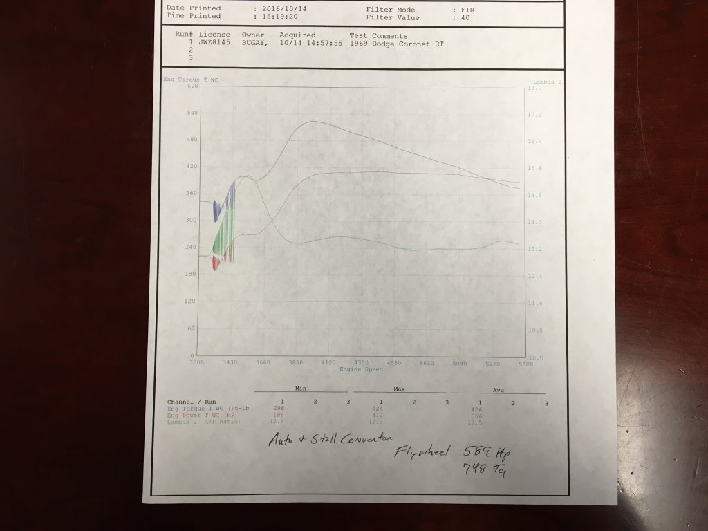

My R/t was finally put on a Mustang chassis dyno last week after the engine was rebuilt with a stroker kit (500 cid) almost a year ago. I was hoping it would be closer to 650 HP, but I am happy with the torque.
Eagle rotating assembly, .040 Wiseco pistons, roller camshaft (do not know brand, maybe Comp Cams) Harland Sharp roller hydraulic lifters, high volume Melling oil pump, Moroso Perm-Align valve cover gaskets, 3000 stall converter with ported Indy EZ-1 heads and port matched Indy intake. The cam is 545 lift with a 235/241 duration and 110 lobe separator / 106 centerline. The compression is 9.6 to 1. Holley 750 carburetor or it may be a 850. The heads were ported by Nick Wilson at Compu-Flow who died shortly so I do not know the flow numbers. The horsepower seems low to me at 589 instead of over 600.

Hopefully these come through.

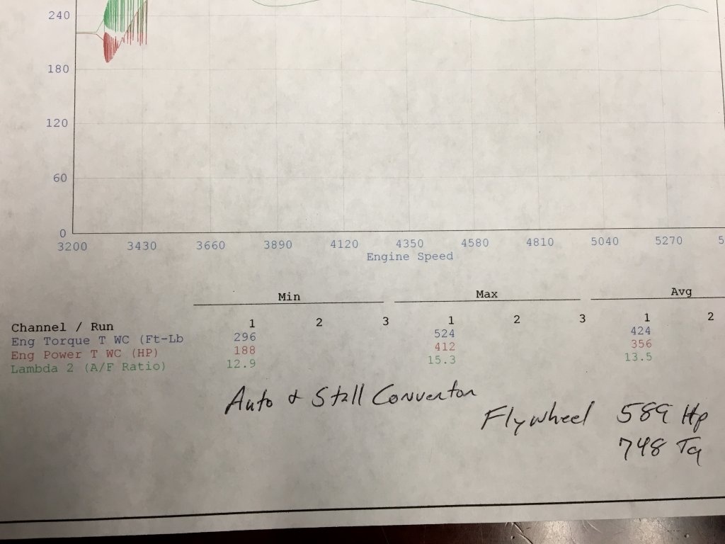

Mark, I'm confused by your numbers. You put the car on a chassis dyno, so the numbers on the printout would be what was seen at the rear wheels? Correct?? Then the handwritten numbers evidently are supposed to be calculated for actual "engine flywheel" HP & torque? Correct??
If I'm interpreting these numbers correctly, that would mean you have a 30% driveline loss. That just seems like a really high amount of loss to me. Can anyone explain this to me? Is 30% realistic?
One of my BB engines on the dyno came in at 505 HP. and 550 ft.lbs. or torque.. after tuning . Street only engine/car. Then after 300 miles on the engine, placed it on a chassis dyno and the HP came is at 375. equates to a 25.7% loss. Supports the theory that the HP at the rear wheel will be 25-30% less than at the fly wheel.
i can't read the attachments, but a stock converter set-up will loose around 20% at the wheels. more converter=more loss. i don't think loose converters on these high torque are a good fit. thats really not much cam or carb for the cubes and heads.

He said a there is an approximate loss of 30% with the 3000 stall converter. I have Indy EZ-1 ported heads on it and I am thinking about going with a different cam shaft. I questioned him last year about the low compression and he said the machinist and he played it safe for pump gas so it would not detonate. I have to pick it up later this week.

It also has TTI headers with a 3" X pipe exhaust with Dynomax Turbo mufflers and 3:55 gears in the rear. They numbers are at the flywheel as he wrote on the sheet and the RWHP is 412 if I read the sheet correctly.
