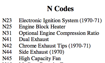

Just had a peek in the option code list, not sure how complete this is but it says that there were only a few options and only available on later models, '70 -'71 Code N42 chrome tips.

I know the '68 Super Bee wasn't available with chrome tips at all. In '69 it was....
what you got if you didn't get that option is the question though, eh?

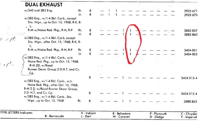

I have not run the car with the new system. It has Dynomax Super Turbo (quiet) mufflers on it now.
That's the "tailpipes - dual exhaust" portion of the factory parts manual for the 1969 models.
Specifically, the section for dual exhaust 383 cars without the chrome tip option, which took a different pair of tail pipes.
The ones circled in red are for the "W" (Coronet) cars.

Or on the factory parts manual itself (which I already posted above), which confirms everything you just stated...
