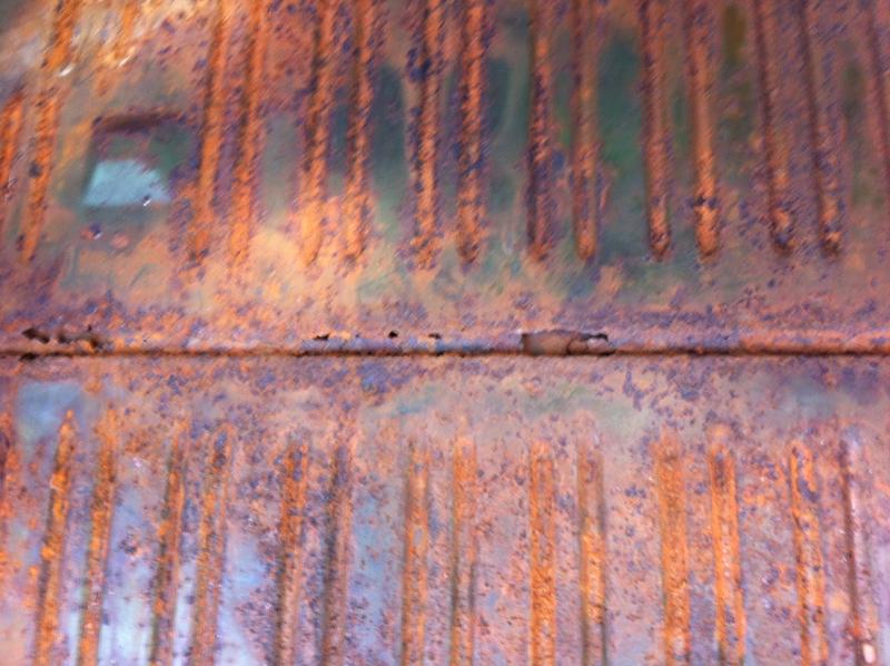

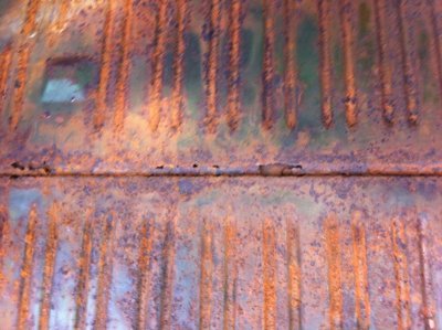

Trust me, POR 15 is garbage. Its sold as a fix all be all for guys on a budget, it will cover up areas you need to replace, it will flake off, it will not prepare properly to receive a paint job. How do I know this? Because back in 2000 I was that guy, then over the years I got smarter. There is NO short cut to doing this right the first time. Removal of old metal is time consuming, no one will do it for free, not even yourself -- because your time is valuable right? When I was in the Army I never had time to do my own cars, hell I have the skills and tools, just never the time! I've media blasted so many cars and projects whereas the owner has an emotional investment in his car, then, its a pile of **** when I'm done with it as it was filled with bondo over rust and a el cheapo paint job thrown on and buffed out...junk! You're at the point where you can do it correctly, and on a less expensive dime. There is no budgets on these cars, its a labor of love, and stubbornness. If you don't know how to weld, better learn...and, hate to say it, but learning how to do it properly takes a LOT of time. There's lots of welding disciplines out there, master the basics; Oxy/Acetelyne first, then Stick, then Mig, then Tig, then do it on Aluminum, Stainless in the flat, horizontal and then vertical, and overhead, yes, all that is actually required to be called a welder! And, these are perishable skills. I had to master all these in US Army Metalworking school, and, I freely admit I would be a mess on a Tig torch today welding some Aluminum because I have not done it in years. If I need Aluminum welded, I'll take it to the guy down the street that does that all day long.
