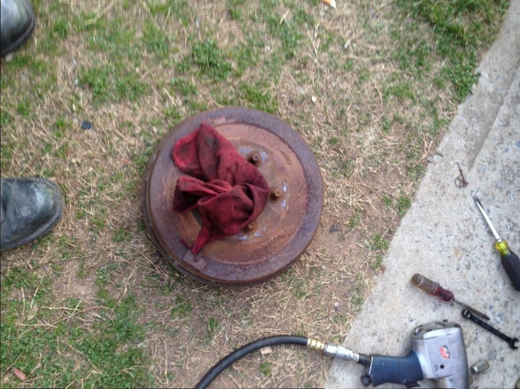

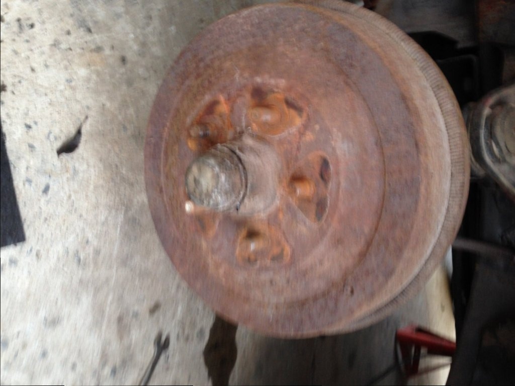

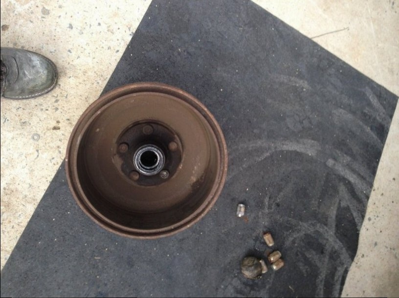

I have a set I just pulled off the Roadrunner the can possibly be turned. I converted to Disc. If you are interested let me know. Also have the spindles and backing plates. And a set of rear drums. The front shoes were heat cracked but the drums looked to be in ok shape.
