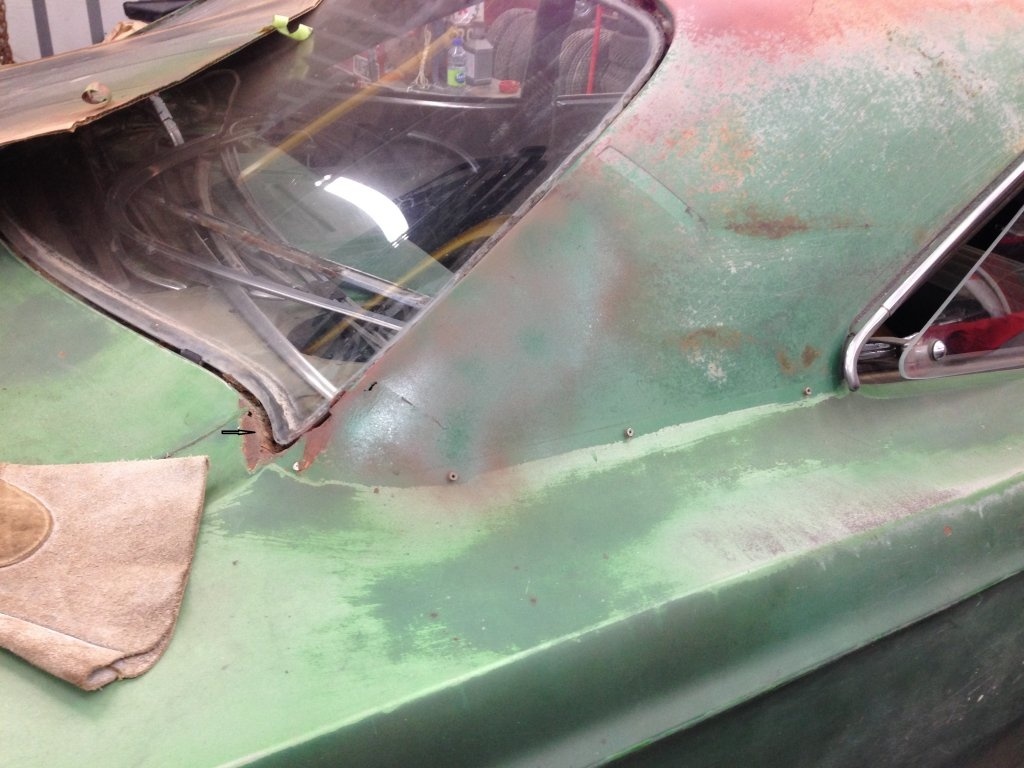

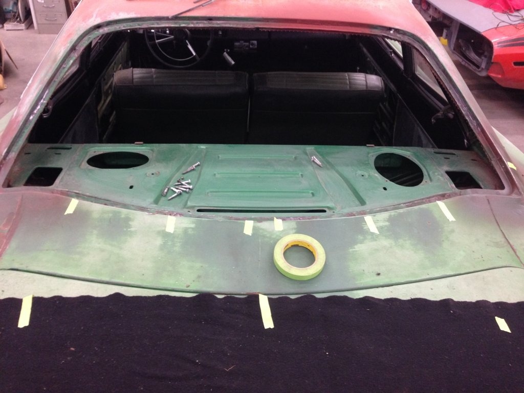

I replaced my old dutchman panel which was rotted so bad that the trim clip holes were missing. Does anyone have pics of where the holes are suppose to go on the dutchman panel side? Measurements would be good, pictures even better. How many clips go along the lower edge?
Thanks!
Here is a pic of mine. I marked them a while back prior to replacing the corners. I'll look to see if I have another pic with the very edge ones. These are all still in position excluding the one by the roll of tape. It is rusted out but presumably there due to it being the center joint of the trim and the other hole being off center.
If you still have your lower window moulding, you should be able to see where the clips were. That is what worked for me.
Very helpful pics, thanks
I didn't even think of looking at the trim. Seems like it was held in with caulk when I removed it lol.
