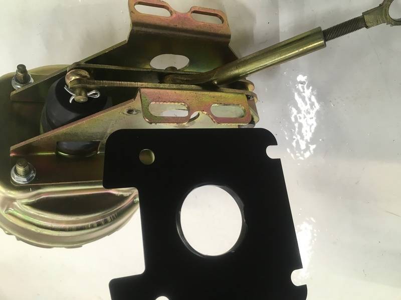

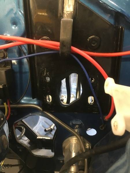

Currently (as I bought the car) the booster is installed with no boot.
I have a boot but it is round and the hole in the firewall is not. (kind of an oblong hole).
Am I missing a plate that should convert this hole to round for the boot?
Thanks!
Didn't work out. The plate I bought has a much bigger bolt pattern.
Anyone know what I need here? Thanks

You need the correct firewall plate for disc brakes with the round hole. Drum brake cars had the oblong hole. You can find new plates on Ebay.
