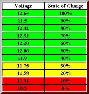

Let's do a simple check of the Electromotive Force that is very easy. Grab a DMM, or voltmeter. Jump the car and start it. Remove jumper cables.
Measure the battery voltage. At idle, optimum should read 13.8V, and can be as high as 15, or so. Let idle a few minutes. Turn on high beams, blower motor, hazard flashers and measure voltage. Still should be in the range of 13.8, or so.
Shut off car, and measure battery voltage. MUST be greater than 12V. If not, it could be the battery, or any of the other items mentioned above.
Static battery voltage readings
