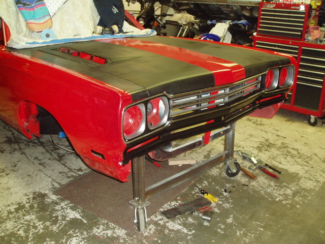

You mean orange with black stripes like this? The outside edge of the stripe can start from either the top edge of the door where it meets the cowl or the outside base of the windshield A pillar where it meets the cowl. I have seen examples of both and the deciding factor may be if the car had a vinyl top. My car had a top and the stripes started from the door edge if that means anything. The gap in the middle is speced at 12" (I think my car actually measured 11.5"). The stripe width is consistent all the way down. The correct paint is called organisol and the code is 9355. It has a slight texture to it and the formula calls for metallic. It's really neat stuff if done properly.

Oh, by the way, the grille filler panel is supposed to be body color. I was just fitting the new part so it still had the black primer on it.

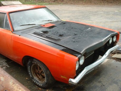

I need to make a correction in my first post. My car has the stripes starting from the edge of the door but the others I have seen started on the inside of the A pillar. Here's another pic of my car before it got painted. Obviously someone painted the hood black but you can better see how the stripes go.
