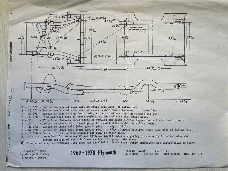

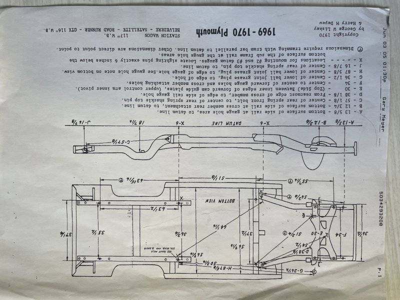

Does anyone happen to have the tru way diagram for a 1969 roadrunner? I have the service manual one but would like to find the tru way. All I can find are ones for a dodge which are said to be different.
I have the Tru-way frame dimensions book
for the 69 Plymouth platform. I could take a picture of the frame dimensions and text it to you. Send me your cell # via start a conversation with me.
Or better yet post it here so we all can copy it
Here you go if it sends
