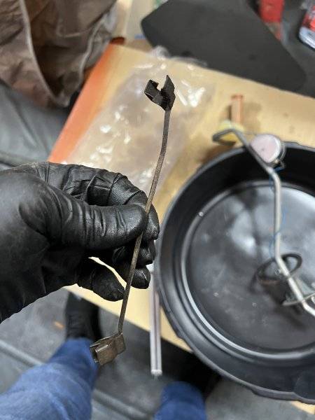

I replaced my fuel sending unit with a stainless steel one. Its shown here on the left. The one I took out is on the right. Looks pretty much the same. The one i took out had blue wire that ran in the tank. the replacement one has a black bar. Was the one i took out an original?
When it was mounted on the tank, I found this small 5" or so bar that clamped to the sending unit and to the fuel line. I assume this was a stock piece and is a ground? I assume it needs to be there? If so, were all the cars the same as having this piece?
The black piece is just a replacement for a wire, you’re good. The other piece that clamps to the sending unit nipple and to the steel fuel line in for grounding the tank.

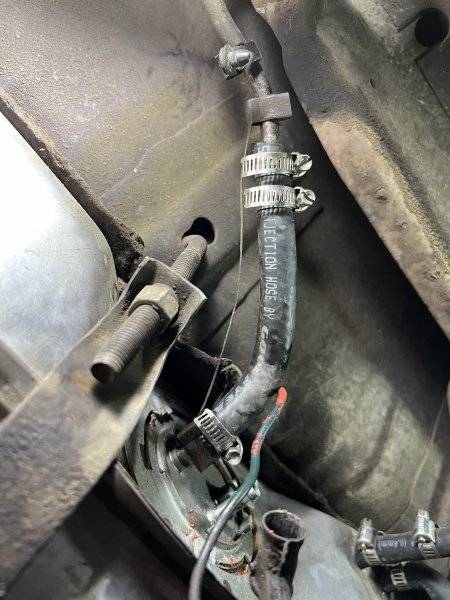

Looks like your going from a 3/8 line with return to a 5/16 w/no return?
