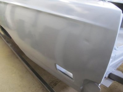

Hi Everyone,

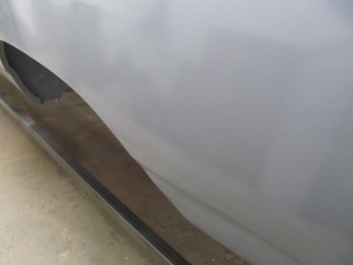

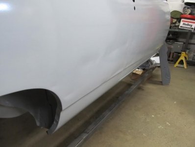

I have finally blasted my car, and I have found many dents in the rear quarters on both sides. I was not expecting this, since the car looked really good.
There are some patches below the rear window, along with lower quarter patches. I would have to have the gentlemen doing the metal work repair the lower rear quarters, fix the rear window area , fix the metal above the trunk gutter, and try to remove some of the dents.
The car is not rotted but has a lot of dings. Should I replace the quarters with full pieces. What is the best way to weld them in? Should I cut them 2 inches before the door striker, area and butt weld them or change them up to the door striker?
Should I fix what I have? Any issues with AMD quarters on a 69 RR. How well do they fit?

I suggest you fix what you have (without seeing it). The aftermarket quarters I have (AMD I think) we're only "so-so" compared to the originals
Unless it's a total disaster, you're better off fixing what you have. The AMD panels are certainly usable, but they are far from perfect and you'll pay your body man to make them fit.
Guys I am worried about the AMD panels not fitting properly. If I can figure out how to post some pics, I could show everyone what I am up against.
Without a visual, impossible to lend an opinion. Somebody's ding is another's disaster. Generally speaking, it's best to use what's on the car, only replace if it's really necessary.
Thanks everyone for the feedback. I am going to try and fix what I have. I will keep you guys posted on the repairs.
Far, far easier to fix (what we can see) than to replace. Are you going to do the metal bumping or your bodyman ?
Trunk pan, metal patches and dent work will be done by my metal fabricator.
Body man is only doing the body and paint. I wish I could do some of this work. I would save some coin. I am doing all the assembly and mechanical portion.
