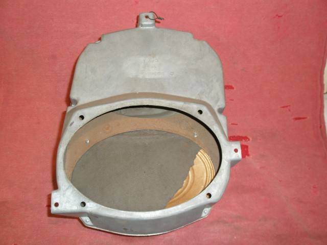

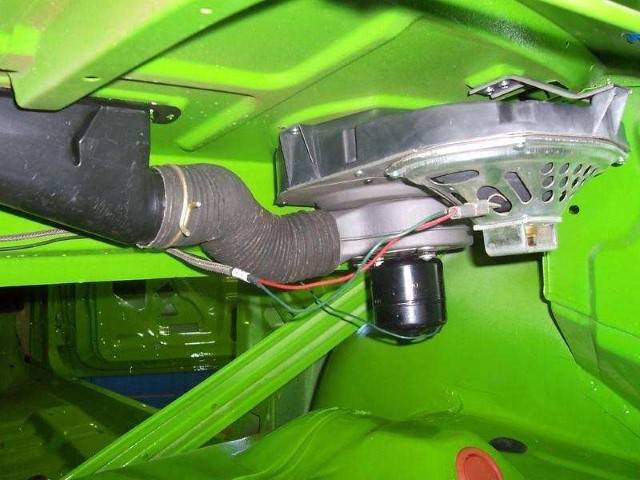

thinking about adding a rear defogger in my RR i believe it mounts to the passenger speaker hole ( i believe) can this unit be mounted and still have the two speaker option seen some pics where the unit mounts below the package tray and pulls air from the rear seat back area any pictures would be grateful or suggestions thanks steve
You need to find yourself a rear window defogger blower motor, speaker adapter.
In this picture the owner of my old car, installed the motor, and speaker, backwards.
