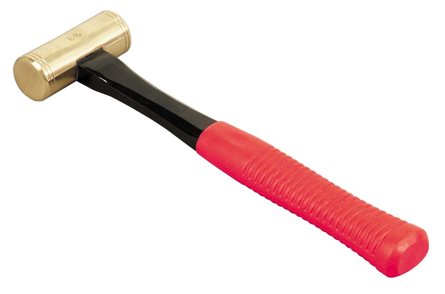

This will do the trick......
LOL AHHHHHH the "Persuader"!!!!!!!!! I like how you think Richard Cranium!!!!! I'll check my Harbor Freight flyer for a sale on one of these and one smaller and one larger for those types of fitment issues. Thanks for the Laugh, my friend!
I just did mine and once the switches are through the holes then the top seats first,then little side to side to align with the screw holes.And yes there was a little persuasion with a screwdriver and hammer,well protected of course.Not fun.Leave the studs loose.Just for a little wiggle room.My two cents.
