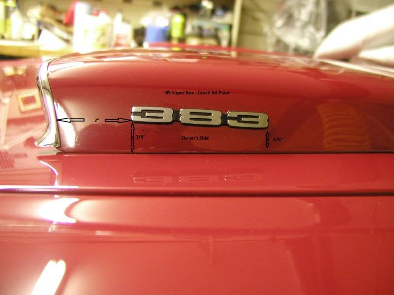

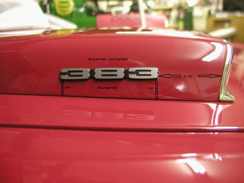

I am looking for factory correct locations, preferably with measurments, of all callouts/emblems for a 1969 Super Bee 383 Magnum with Ramcharger hood.
Is there a page/diagram of this somewhere?
Thanks in advance.
I believe the 383 four barrel engine callouts on the fenders are moved to the ramcharger scoops on N96 cars and only have 383 chrome letters on the sides of scoops. @dadsbee would know where all the callouts are for the car I believe.
Bulge hood, script goes on fenders between wheel well and door. Ramcharger hood simple 383 on the scoops. That said, the hood on my car (that I borrowed off my buddies car in 1978) has never had scripts on it, nor signs of holes ever being filled in. I prefer it blank. Mopar and Missles car that he bought new has scripts on both the fenders and the hood scoops! Both of our cars are Lynch Rd cars. Not sure if my buddies was same or a St. Louis car.
Courtesy of Mopar and Missles..

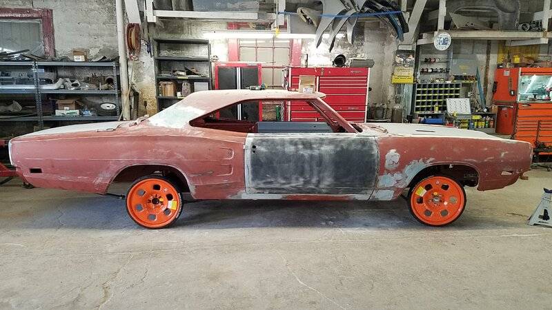

Pics of the Bee when I bought it in 1990 and pics as it sits now, at the restoration shop.
