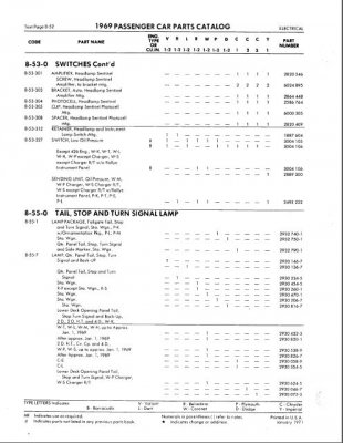

[FONT=verdana, arial, sans-serif]Can anyone clarify this matter. I have a set of 69 coronet tail lights. The lens are somewhat flat in nature and there are two light sockets. There is another set of lens for the coronet that have three light sockets and the lens protude outwards. Ive been told that Chrysler made a mid year change to the lights resulting in the differences. The part numbers are the same but the lights are different. Are the flat lens two socket fixtures applicable to the 1969 Super bee.[/FONT]

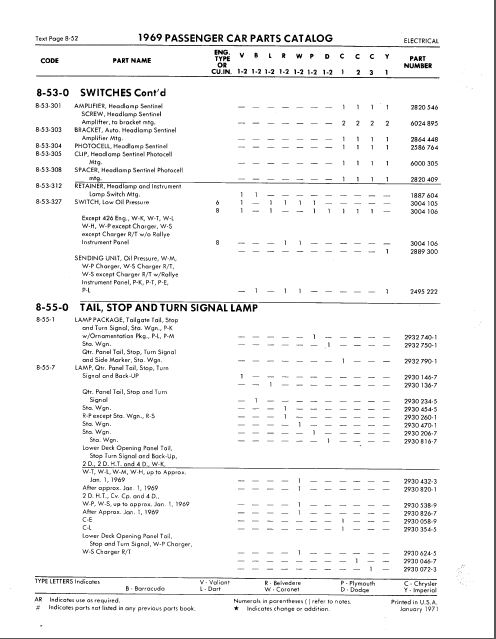

It will depend on the build date of the car. If before 1/1/69, 2 bulb, after, 3 bulb. Factory reference attached below.
Hope this helps....D
So what this says is rear taillights are the same on all coronets including super bee. The just changed all lights to fit all coronets built after 01/69
