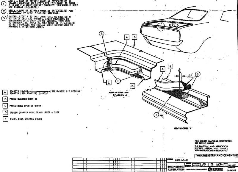

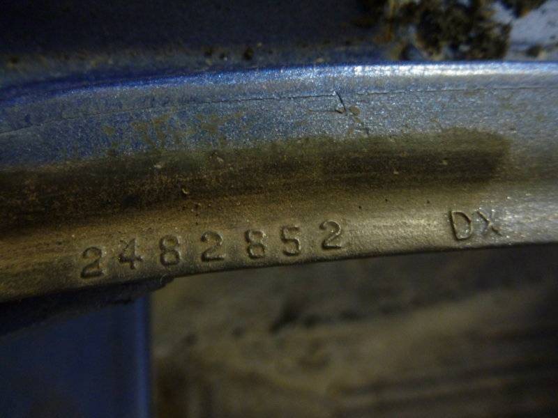

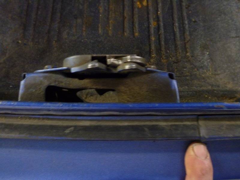

A '69 Lynch Road car.. didn't have said lip, they just used a roll of continuous seal and cut to length. I found a nice one and my paint guys thought they'd help and glued it upside down.. then I couldn't find another the same. Richard / 69Bfan is your man I bet to find a good one. Pic of my OE..

I should have a couple of the seals remaining that was reproduced off of my NOS samples. I am picking up another 6000 feet of the seal in approximately three weeks, so it will be back in stock at that point. Running 9000 feet of extrusion so that we can offer the style with the lip and the flat style as found on the E-Body applications.
Most people believe that one style was used from 62 through the late 70s. We have available the 62 year model only style, 63 to 72 style with a lip, 63 to 72 style without a lip, late 72 and up hollow style and the 73 and later "D" style. So not all trunk weatherstripping is the same and year model and body style does make a difference on which is correct for your car.
