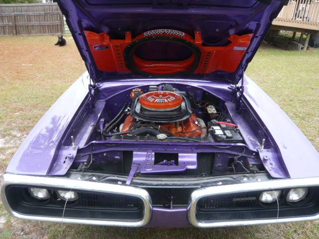

70 boxes are Orange.. on Dodges anyhow. Maybe the GTX in 70 was an oddball, as Roadrunners got an entirely different air cleaner in 70.

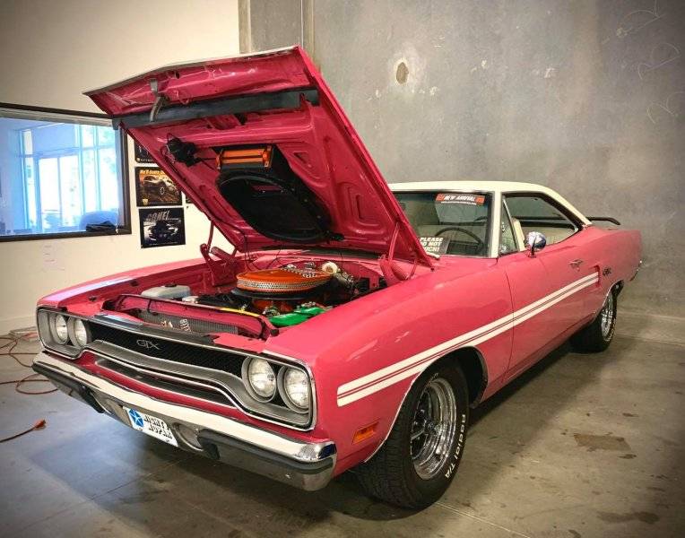

Check out this 1970 Plymouth GTX 440 Six Pack 4 Spd in...pink, oh yes, PINK!

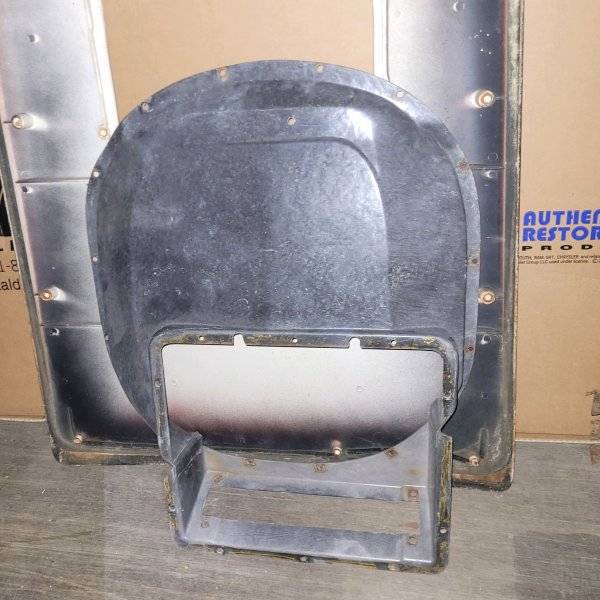

Here is an original. A 70 Gtx/Road Runner uses nothing like a Dodge…
That's the part. More gray with a very slight brownish tint in the sunlight. I had thought about blasting it with some walnut shell media, but I don't think that would blend in the discoloration of the scratches. Glass might really make a mess of it. I might have to take it to the paint store and see if they can mix up a rattle can to match.

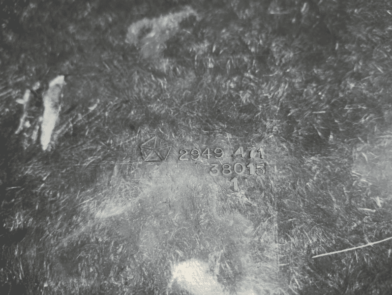

The air grabber box is a medium charcoal gray, but not a consistent colour that you can recreate with paint. It is made of molded fiberglass reinforced plastic, and shows little whitish/light gray threads of glass against the darker gray. Once cleaned up, you could try some satin clear, which would also cover scratch marks. This is a colour picture, taken in daylight without flash.
Agreed 100%
IMO, glass bead the assy and lightly clear it
Eastwoods Diamond clear has been the best for me
