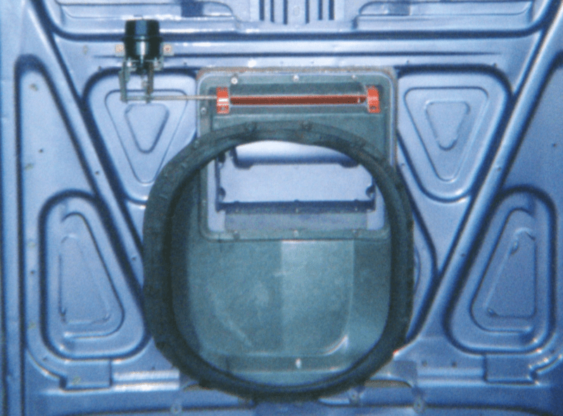

Can anyone tell me how the air grabber duct is fastened to the underside of the hood? And is there a gasket that goes between the duct and the underside of the hood? Its all aftermarket stuff with no directions. It looks like the 69 is riveted to the hood but this kit came with nuts it appears.

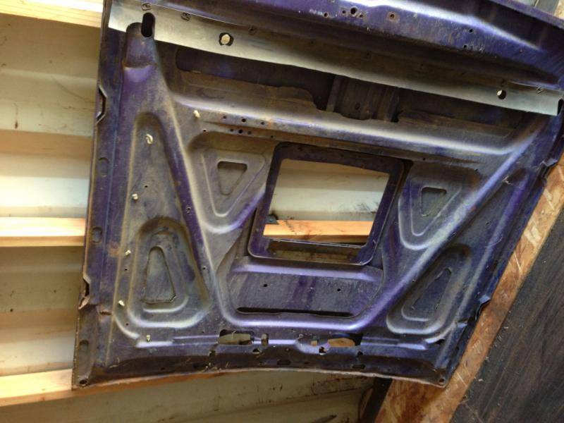

Been awhile, but I think on mine there was a rectangular steel frame under the cut-out, slightly larger than the hole. It's spot welded to the underside frame of the hood. It has 1/4" studs for those nuts. And there is a gasket, like this: https://www.ebay.ca/itm/Mopar-B-Bod...ash=item43ab59b062:g:THsAAOSwmcZbZ2mN&vxp=mtr
This is the hood opening and frame with studs that pg classics offers: https://pgclassic.com/103-mopar-1970-72-b-body-air-grabber-hood-opening/
ok thanks my hood is a the painters so it must already be on there then thanks for the pic
