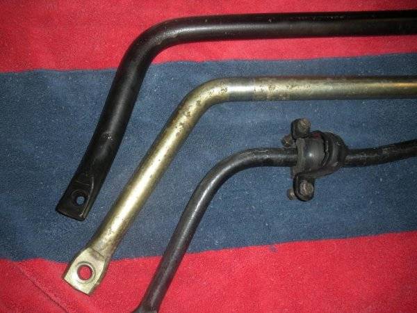

I modified a 1987 Chevy 1 ton 2wd front sway bar to use on my 70 Charger. 1.25" solid, it was the biggest that I could find. Hotchkis or Helwig makes a 1 3/8" bar but it is hollow. They are lighter but not as effective.
Size comparison.
Top bar: GM truck 1.25"
Middle: Addco 1.125"
Bottom: Stock 7/8"
