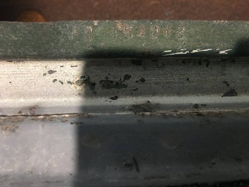

Hi I have 70 Plymouth B Body.Number stamp on trunk lip is AO 154042. I do not have original dash or radiator support.Is there any way of telling if it’s originally Gtx,Roadrunner,Belvedere or Satellite.Thanks for any information.
Pretty sure it’s a Lynch rd car due to the “A”
Maybe try the prefixes of RS23 or RM21 etc in a mopar vin look up and see if anything comes up
RS23UOA154042 as an example.
U is a 440, forget what the 383 letter is
Just guessing

Ok Thanks for the information.It is a post car.Don’t know if the Gtx came out as a post car?
Two doors or four?
Pictures help here....
