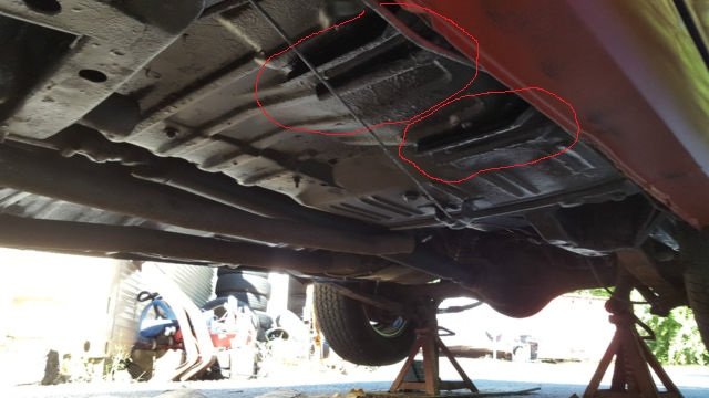

Hey guys, I have yet to order some reproduction seat tracks for my 1970 RR bucket seats. The floor in my car has been replaced and I have the inside(trans tunnel) holes but not the outside holes. If anyone has the dimensions of the mounting studs I would love to mark them out as I’m putting in sound deadening. Thanks
The 2 brackets coming out from the inner rockers have holes drilled in them, just drill up from the bottom.
Pic borrowed from internet
