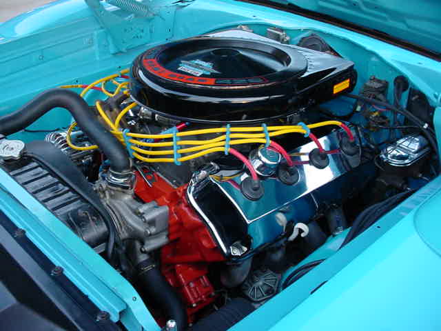

I've done that. Except into a Superbird. But no difference. I used the Shumacher mounts to keep from having to source a k-member/brackets and mounts. The Shumacher mounts worked perfect. If you have power brakes you might have to buy Hemi brackets. The are other small changes, alternator brackets, pulleys ect. But all little stuff. The Road runner is made for a Hemi. I'll find you a picture of when I got done. Good luck. It's fun.

I was happy with the result
I swapped a 440 Sixpack in one of my Chargers with a 426 Hemi with the Schumacher conversion mounts as well and was I able to retain the vacuum power brake booster with no mods required.

The Schumacher mounts should put the engine right where it needs to be. My fan was right in the center of the shroud.
