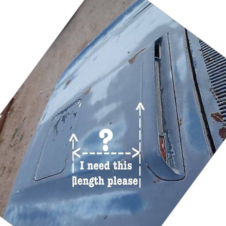

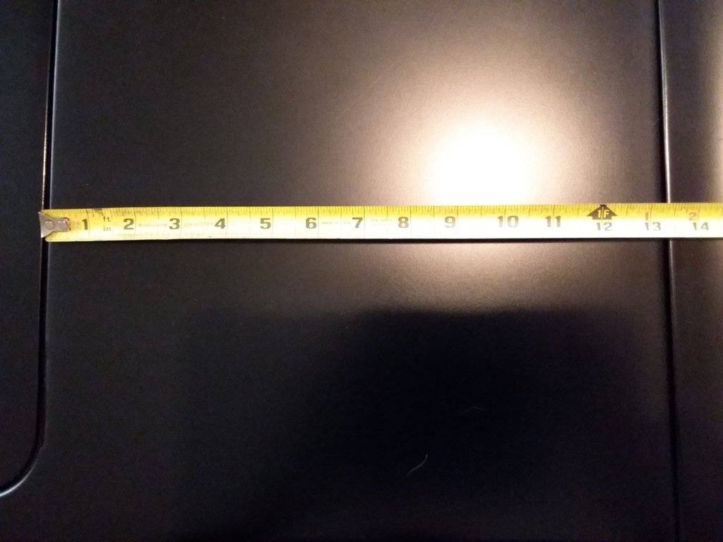

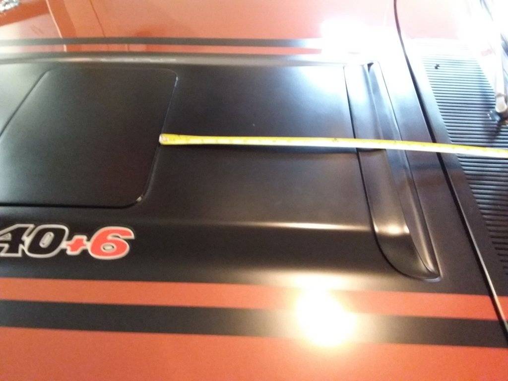

Hi guys, I need the help of you guys that have a 1970 Road Runner with Air Grabber hood. I just picked up a 1970 Road Runner hood with Powerbulge, but it doesn't have the Air Grabber scoop. I need the dimensions either from the front of hood to front of cut out or from metal end (where the engine callout/ blinker insert connects) to back of cut out to know where to cut the hole. 2 sample pictures below, also if I could get the side to side and front to back measurements of the hole, that would be great. The more measurements the better. Then I can install the from in the third picture, but first I need to know exactly where it goes.
Thank you for any help, I really appreciate it. Duane
I get 13 3/8 to the edge of the insert.
