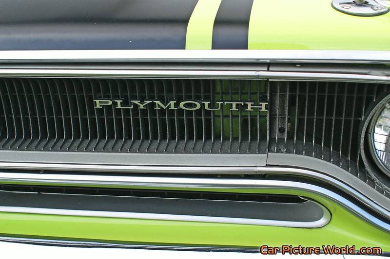

Should the black in the 70 Road Runner grille be semi gloss black? It appears the "textured" area was black, but its faded some, so I can't be sure what gloss to use.
These is no black paint on a 70 RR grille.
The paint is light textured argent, and dark textured argent.
He's right, the fins are dark argent. Don't be fooled by those new repro grills that have black centers.
The only black is a portion of the top of grille where the plastic push in buttons go. Look at 877-4-paint on internet if you want textured argent paints.
So should the grille and headlight bezels for a 70 RR be dark argent , or is it both dark and light, and where does each color go? I am new to the 70 RR grille's, so i have no clue. TY all
Someone mentioned also contacting Totally Auto and he will let me know what needs to happen. TY.
