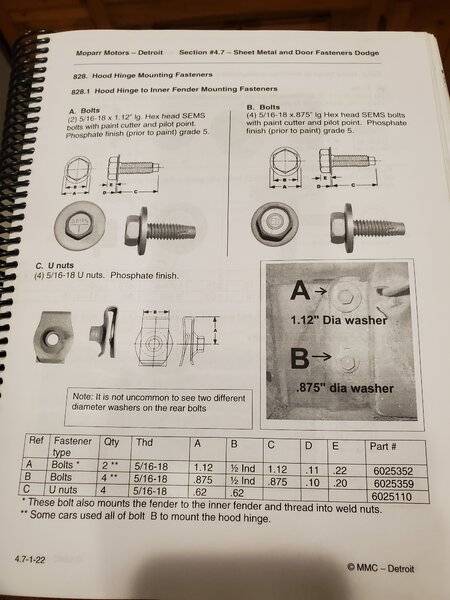

Did they use 3 of the 7/8 washer head bolts, or two 7/8 on the rear and one 1-1/8 at the front.
For what it's worth, my '68 Charger had 2 different size washers on the two rear bolts, with the larger one in the top hole.
This page is from the MMC-Detroit reference manual for Dodge B-body cars. I'm not sure about the Plymouth.

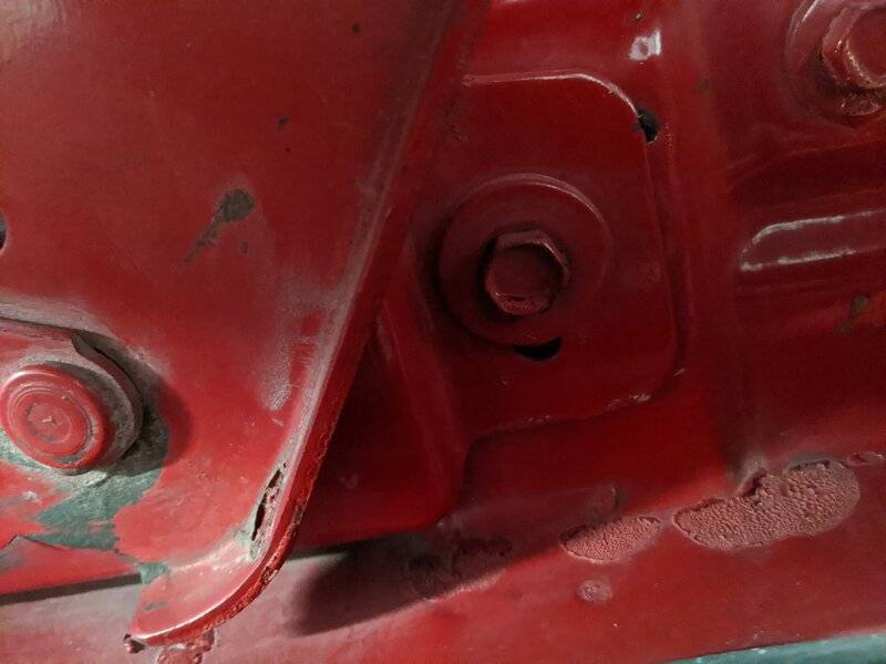

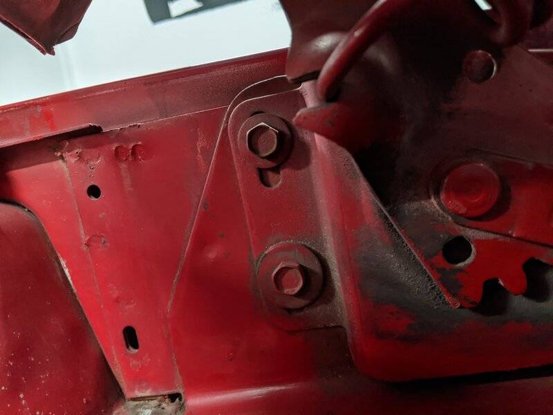

My 1968 Charger survivor. The hinges have never been off or adjusted. Smaller washer in the top rear. This is the left side and it's the same on the right.
Larger washer in the front....
