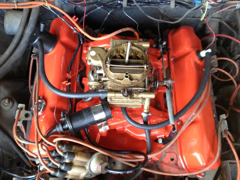

OK, so if you need a new carb, you also need to determine if you have a CA car or not. The CA cars had the CAS (Clean Air System), so the carb had a vent line that went to the valve cover air breather. If you do not have a CA car, you will not have that vent line.
This is a picture of a correct California spec Holley carb. Note the line from the front bowl to the air breather...

Yeah, Lynch Road would not have had the CAS system, to the best of my knowledge.
Since you have a Holley, the carb you specified in your post above should work. If you want the actual correct carb, let me know and I can look that up. But you will need to find one which is not always easy...
