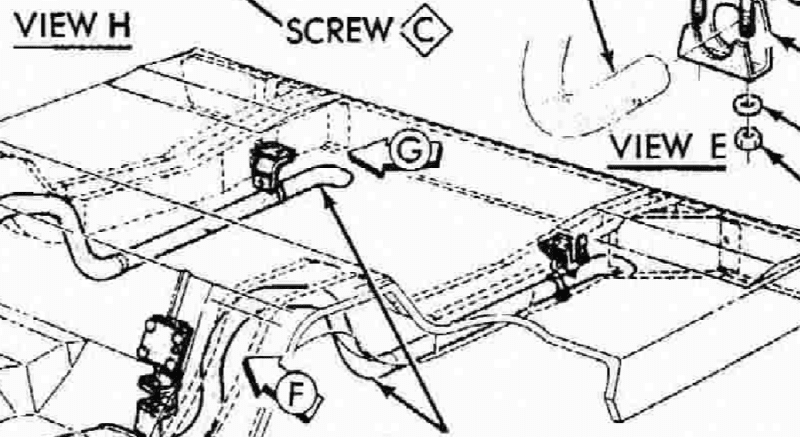

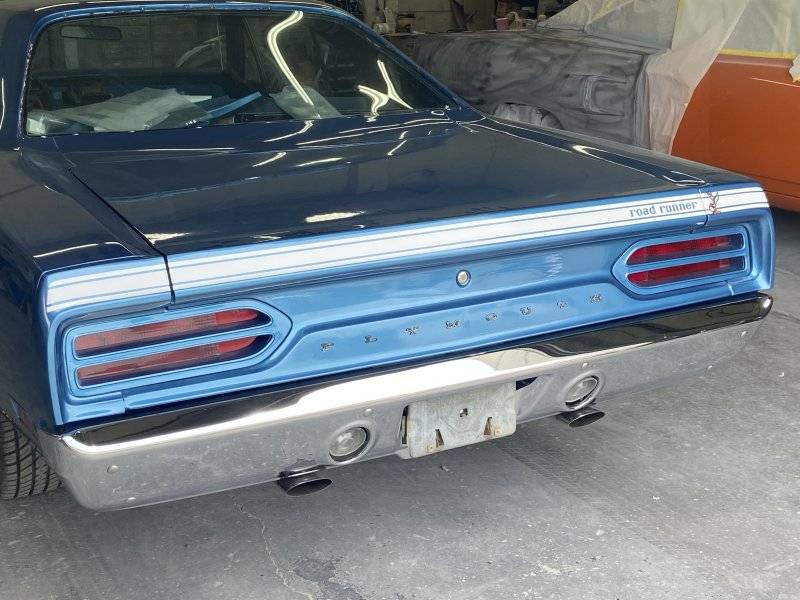

They are either tilted down as shown (standard) or have straight out exhaust tips (option)

I saw your post in the new member welcome section. As other people have said, if the car's production plant was "E" (Los Angeles) in the seventh digit of the VIN, it would have been built with factory turn down exhaust tips exiting at the back bumper as shown in the drawings that have been posted. I have read that the reason for this was that it had to do with California specific emissions and maybe noise regulations that forestalled ordering any other exhaust tip option.
