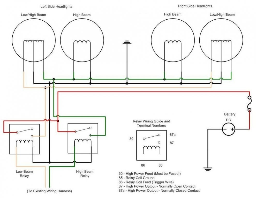

I am converting my 70RR to relays and H4/H1 lights. Maybe take a look at doing that also, or doing the relay setup so you can off load the power from the switch to the battery.

I would go the relay route also. Found this diagram to give you an idea. Its from http://www.rowand.net/Shop/Tech/images/HeadlightRelayWiringDiagram.jpg
