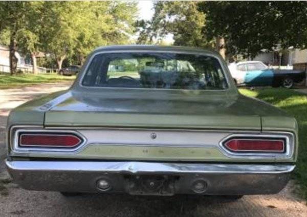

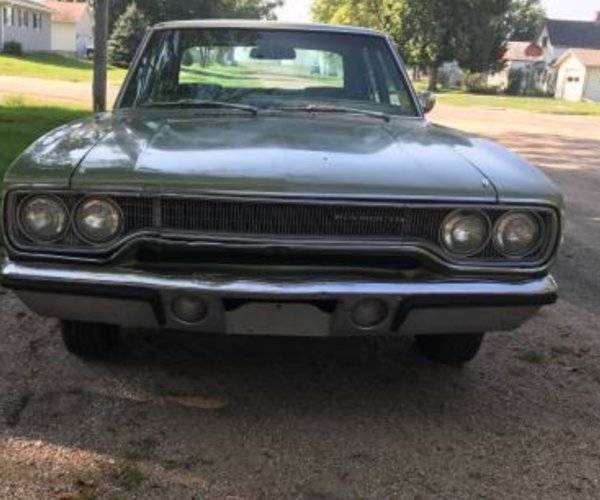

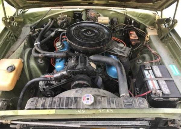

looking at a 4dr satellite as a donor for my roadrunner and GTX. My question as a novice: is this a good idea and at what price would it make sense. How interchangeable are the parts for these cars. They are asking $3600 for a AC car with good paint, body, frames, etc. I think at $1000-1500 I'd be in if the parts are interchangeable given the condition of this car.
Everything on the front end will swap, bumper, hood, grill on the roadrunner, fenders, K frame etc. Trunk lid and back bumper will work. Back window looks like a 4 door window, so doors will be no good, seats will be no good either. But the dash will work for you, though not in the gtx.
