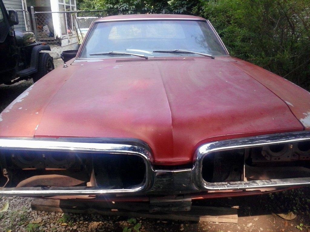

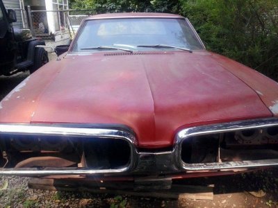

Mine is chrome also.
Although this car was originally a 500
The center chrome is a separate piece, but considered as part of the bumper also (!?) as it is always there. Most 2 door models have the painted applique (bolted/riveted over the chrome piece) like R/T, Super Bee, 500, but 440 is inconsistent. No applique on taxis, police, wagons. Not part of a fender tag/broadcast sheet code option.
Yes, this has been debated as figuring out most Mopar ways is a clusterf@#%. But that contributes to the mystique, no?
