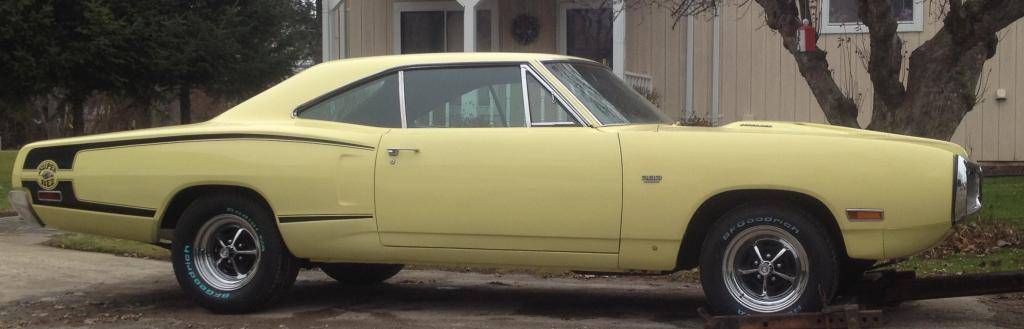

Well I guess this gets me even more excited cause I am told that that the light yellow color ( original paint) is also a very rare color for this car. And if this car could possibly have a Dana with 4:10 gears then how rare and how much worth. It is an AC car also

Color breakouts for 1970 models are known. What is the original color? Color would add minimal, if any, value to the car unless it was something like FM3, originally a (documented) two tone car, or an odd combination of colors. Depending on the color (something like L1 beige), it could lower the value.

I'm not good with colors but that almost looks like it Y2 Sunfire yellow to me.
Y2 was not available on 70 Bee's.
Does it appear to be something besides Y2 Yellow to anyone else?
Appears to be a 383 car with standard hood and stripe. What seats (If any right now) are in the car? I do not see any headrests.

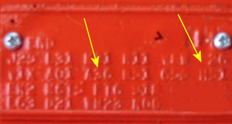

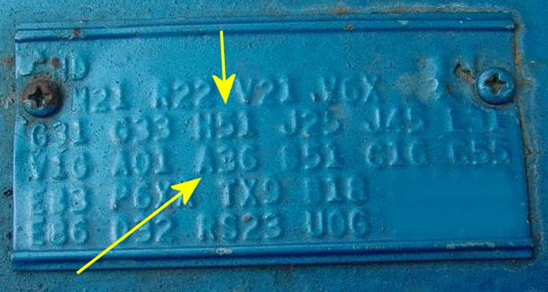

For some reason, the 70 Dodge data book seems to have a lot of typos and wrong info. That is one of them. A/C (H51) was available with the 3.55 gears (A36). What you had was certainly not common but was available.
