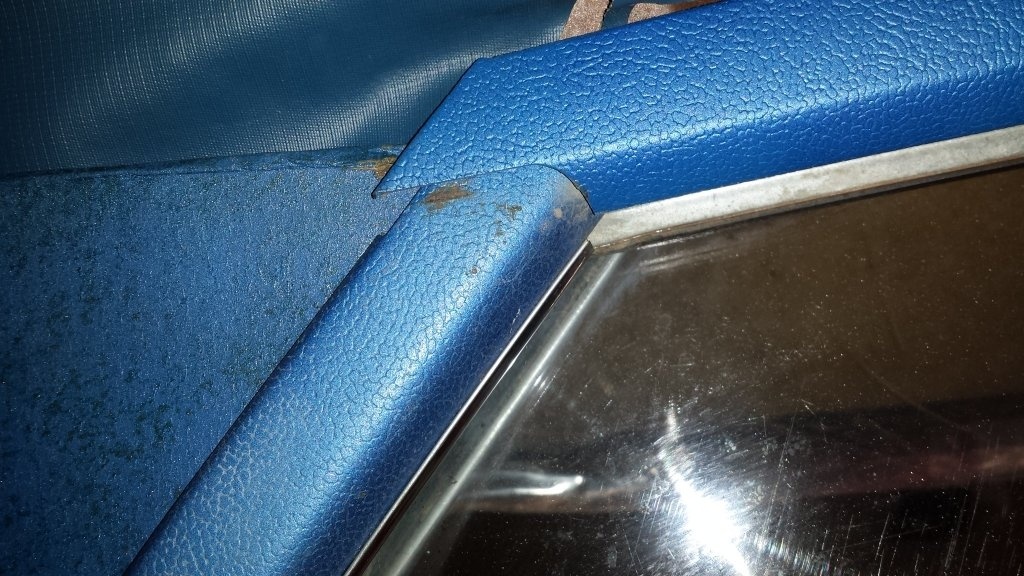

Hello I was wondering if the 2 side headliner interior trim pieces (RH & LH) are the same for all 1971-72 Plymouth RR/GTX/SAT and 1973-74 RR/SAT. Satellites being 2 door. Below is a pic of a pair from a 1973 Satellite 2 door. They measure 33-1/4" in length.
To me my guess is that would fit all years 71-74 as they seem to have the same roof lines.
Thanks, Bryan
Actually 71/2 Plymouth are 35-1/8" long and have this notch at the back to go around the 71/2 Plymouth only quarter glass trim.
