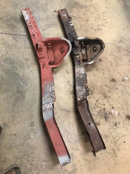

Yes, I put an E Body donor in my ‘71 RR. The donor is the red one. The only differences I found are three holes in the front part of the rail on the E Body one and the E Body one was missing a hole toward the back of the rail.

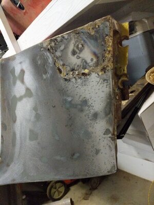

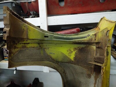

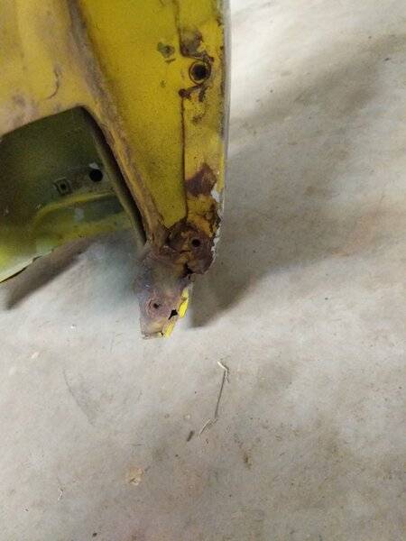

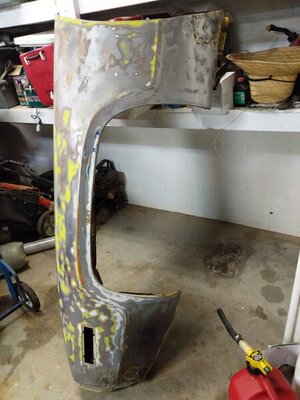

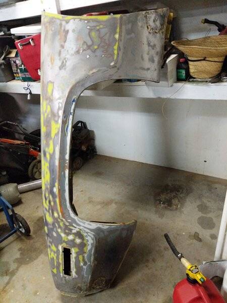

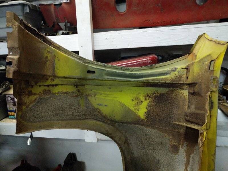

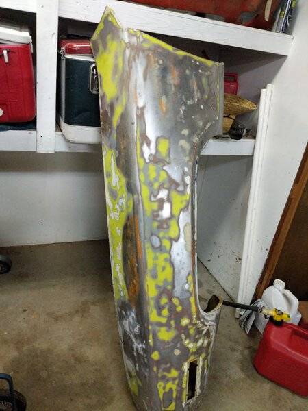

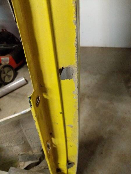

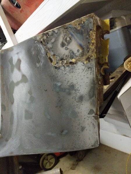

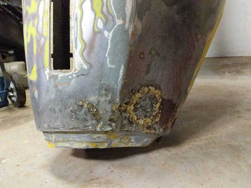

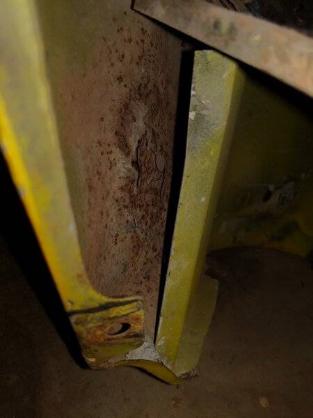

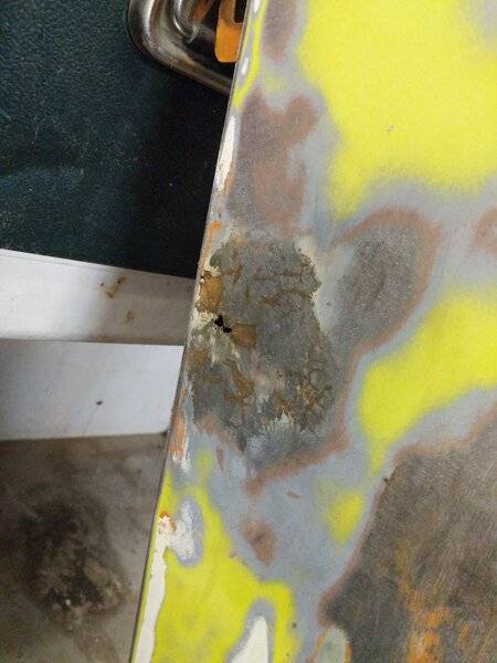

Your fenders ad was closed so I posted pics of the 71 fender.
16212164550875816977523226679200.jpg 16212164781025130732632290527530.jpg 16212164969865785243985164156468.jpg 16212165186127011446272592943596.jpg 16212165341118094283543170226649.jpg 16212165734168052971455155119137.jpg 16212165873787816978716088645879.jpg 16212166075638297408680956449439.jpg 16212166319686822793323602294126.jpg 1621216646119300159862189568185.jpg

The close pics show some patches because of rust is that right ?
I can't see on the pictures if the headlights bezel is present ?
