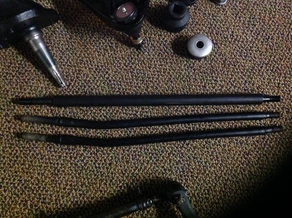

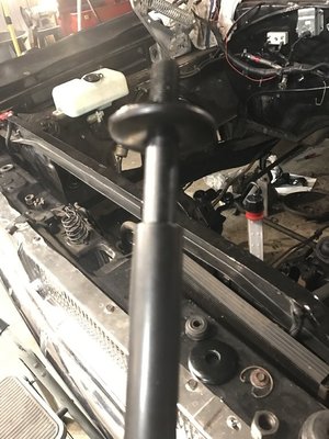

Ordered the H D Mancini Strut Rods
You can see the one in the picture ( Top) next to my factory strut rods
You can also see the factory strut rods have a dog leg bend in both rods , in the exact same location
K Frame has been powder coated and straight as an arrow perfect
Lower control arms , new bushings and straight as an arrow
Make a long story short
These Mancini Strut Rods will not fit , not even close
My factory strut rods are about 17.5" from shoulder to shoulder
Mancini is 18" - Obviously these Mancini Rods are sweet , but no way they will fit , even with no inside bushing let alone the Moog bushings or Energy suspension bushings that I have
What am I missing here ???

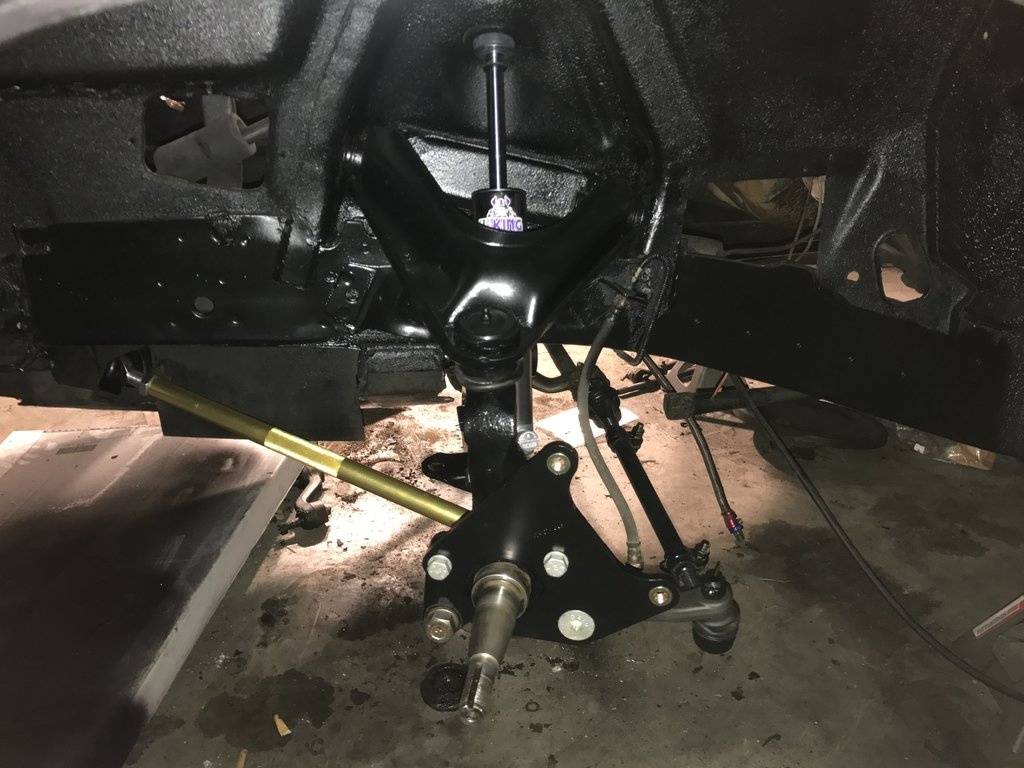

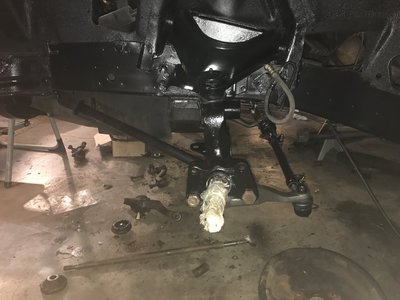

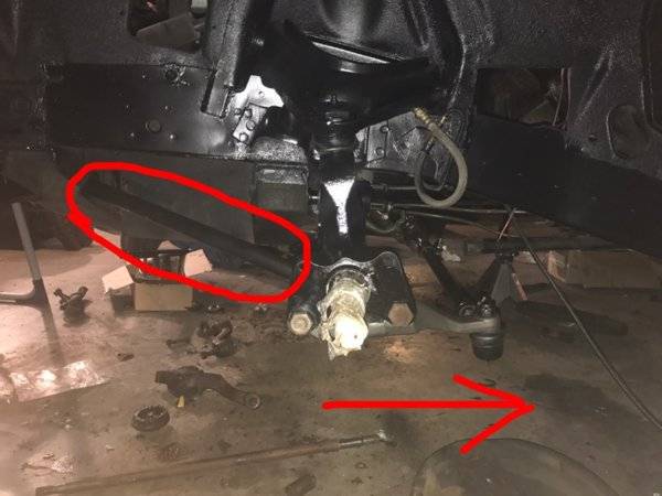

Here's some photos with the mancinis on, as you can see the geometry was way off. Mancini tech was absolutely no help they basically told me it should fit. Went with the adjustable qa1's and that solved the issue.
IMG_1083.JPG IMG_1180.JPG IMG_1181.JPG IMG_1183.JPG IMG_1184.JPG IMG_1217.JPG IMG_1219.JPG

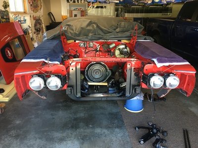

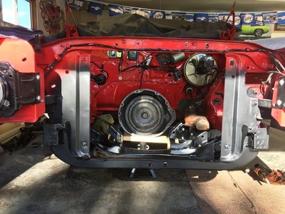

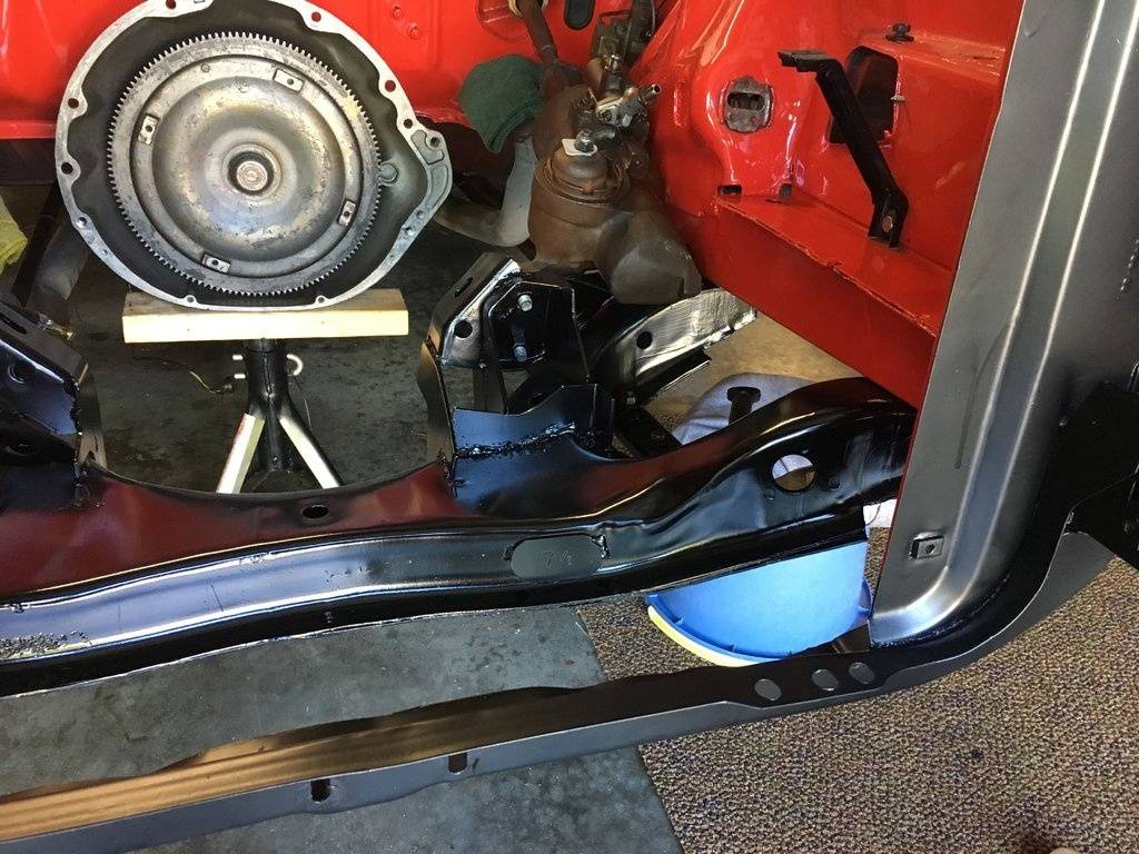

Just wanted to see how everything was going together with the new old k member that I picked up last month
I have new strut rods ordered
Just wanted to make sure everything went together fine and it's wasn't these Mancini Strut Rods
My car is down for a few more weeks anyways
Numbers matching Tranny rebuilt and installed
Working on front suspension after installing new old k frame that was sandblasted , factory skid plate , looks sweet compared to my factory unit
And of course , 383 magnum numbers matching block getting line bored , Mancini Racing 432 stroker kit getting installed along with Edelbrock heads
Car has been in pieces since May

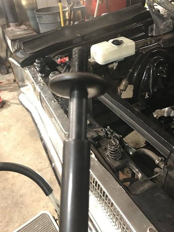

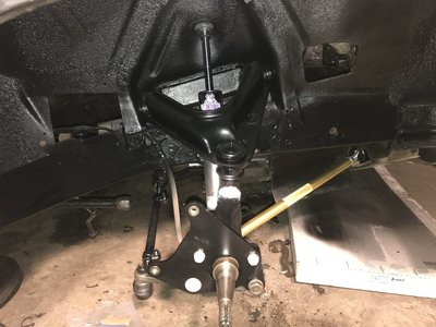

Went to torque down the upper ball joints that are included in the new / reproduction upper control arms cheap on Ebay , because one was hand tight only , even bought the correct socket from Summitracing
Anyways
Drivers side upper control arm stripped , wouldn't even torque
Passenger side is fine
What next
Red Loctite ?
Quick weld in a few spots ?
Throw car in garbage ?
I've just had the same strut rods delivered for my 66 Satellite and like you I compared them to my original (and bent) strut rods and they are slightly longer. I sent a photo of the comparison to Mancini and the rep replied that they were fine, that is the design, they sell loads of them with no issues and they will work just fine. Hope there won't be an issue but am concerned as return shipping is costly from Australia. Surely they wouldn't be selling a product that's clearly wrong?
From another thread over at Moparts
Quote:
Thanks for the update. We did change vendors and told him to shorten to the
correct length.
Thank you for writing
Rob Cunningham
Mancini Racing
Manciniracing.com
Same problem with Mancini rods here, they were way too long.
Glad they finally listened. I ended up getting mine turned down 32mm each I think by a local engineering firm. $20 a side. I knew Mancini were fobbing me off but I couldn't be bothered to argue. It's kinda satisfying fixing the issue yourself anyway.
