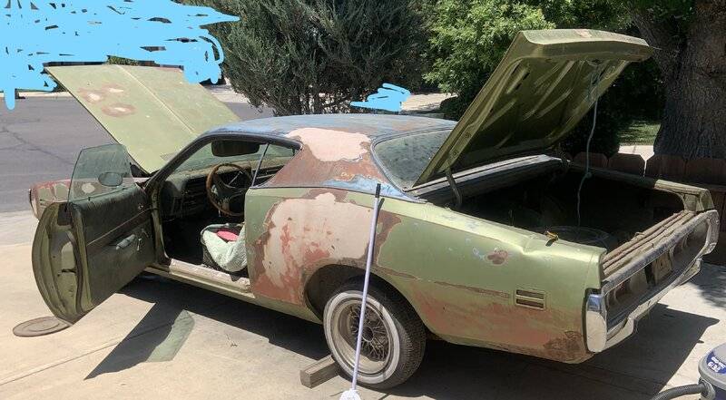

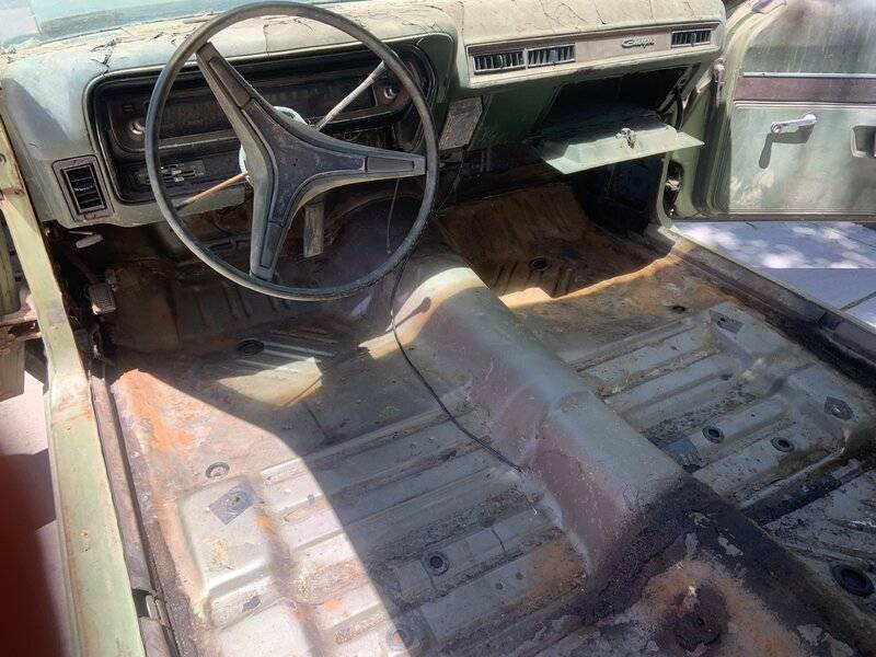

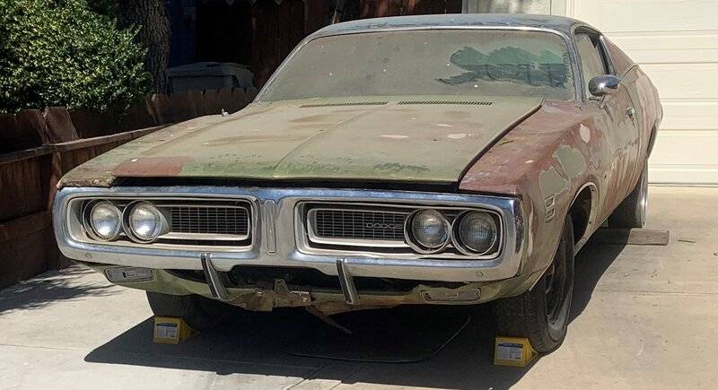

Hello all. I have recently picked up a 1971 Charger. The car is an original 'G' code car with the number's matching 318 engine and 3 speed auto transmission. The car is complete, and it has nearly all of the parts that the car originally came with. It is an AC car with power drum brakes and power steering. Two fender tag car! The car has been in some fender benders as can be seen by the pictures. This Charger came with a green exterior/green interior combination. Green bench seat with column shift. The interior needs to be completely redone, but I do have the original front and rear bench seats that can maybe be reupholstered.

Also, the instrument cluster needs to be replaced: circular cluster or horizontal?

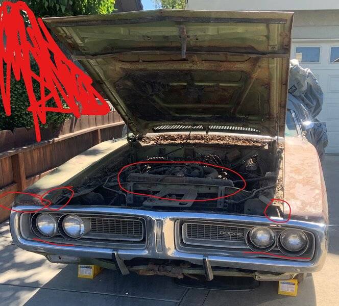

ONE PROBLEM: The frame seems to be bent because of a fender bender. I have circled the indications in a picture.
I am somewhat concerned about the cost of straightening the frame.

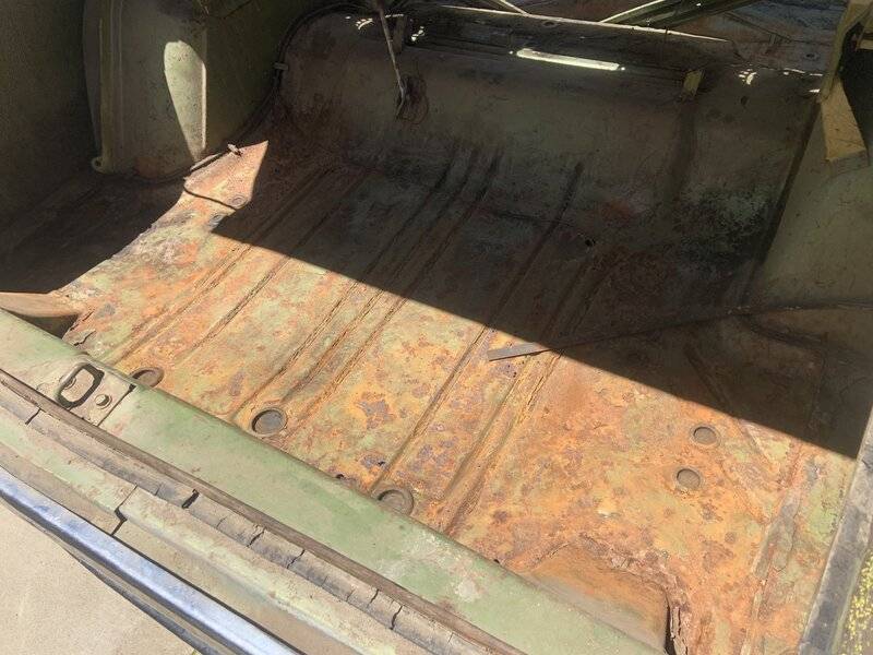

Here are some pictures:

Thanks everyone for the responses. My apologies for not including the picture that concerns me about the frame.
As can be seen, the radiator is crooked, and those beams that are circled are not the same length. The headlight housings are not centered correctly either.
I know that these issues may not mean that my frame is bent, but it is something that I will definitely have to look at.

This car looks pretty solid and a good starting point for a project.
My guess is that your frame is fine and just your bumper/bumper bracket are bent.

Looking at your pictures I do not think the frame is bent, the radiator may be mounted poorly or something but I would not make decisions based on that. You can figure this out by taking some measurements and conducting a close inspection. If the frame is bent you will probably see deformation in the rails.
