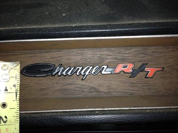

From my understanding the 1971 Charger R/T dash emblems are not reproduced and the couple that I have seen that became available were quite pricey as there were just over 3000 released in cars. I have an acquaintance that reproduces similar pieces in various plastic resins and does good work. I have reached out to him and he is willing to undertake the project. Since he is doing me a favor I wanted to see what the interest would be for him to make a few dollars for his time as I know I have seen a few people looking for these. No commitments, no money, I don't get a price break at a certain number. Price is not even set. I know there will be a lot of questions, but maybe just people that currently need one, not even people that would actually buy one. His other similar products are typically $75 and less and are virtually indistinguishable from the originals other than the plastic make up.

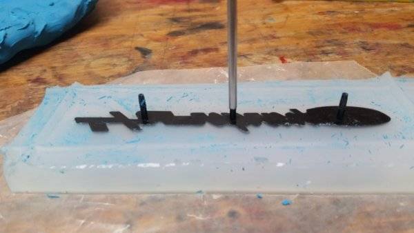

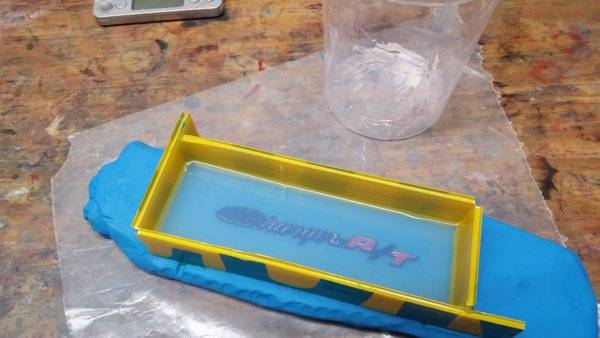

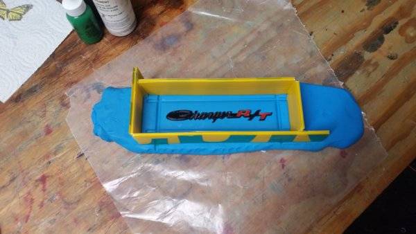

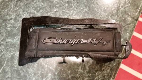

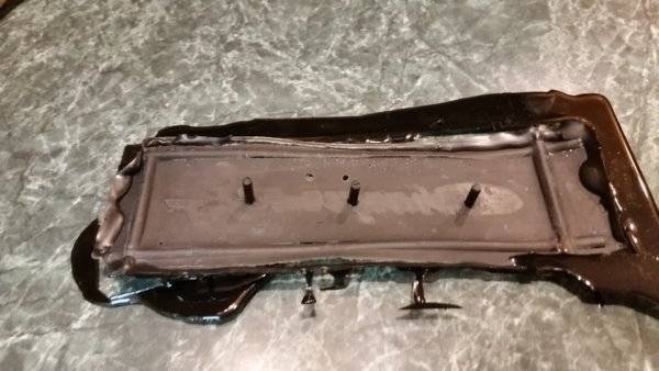

After evaluating how the emblem is made, the producer, doesn't feel that he can reproduce these in a quality that people would want to buy. IE, the details like the silver outline and the red in the R/T would have to be hand painted and after discussion with me, we decided to beef up the mounting pegs slightly. This is fine for me, but I am sure many others would criticize as he is not a professional molder, but rather an HVAC tech that dabbles on the side. That said, here is the first from the mold.

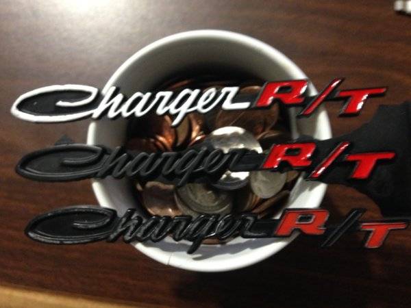

These were the first couple out of the mold. There are some voids around the edges. He asked me to try painting them to see if the voids would fill with paint. He ran a couple more with a higher mold pressure and had better results. The paint is still wet and looks sloppy up close but its a first coat and the bottom one is the original, which you can see that they were not particular with their red paint either. I also think I need to upgrade to a higher quality paint.

The guy I had make them actually passed away unexpectedly. He make 3-4. They were pretty nice but the initial ones has some tiny air bubbles about the size of a pencil lead that prevented a perfect finish. They filled in with paint and from 3-4 feet away they weren’t noticeable
