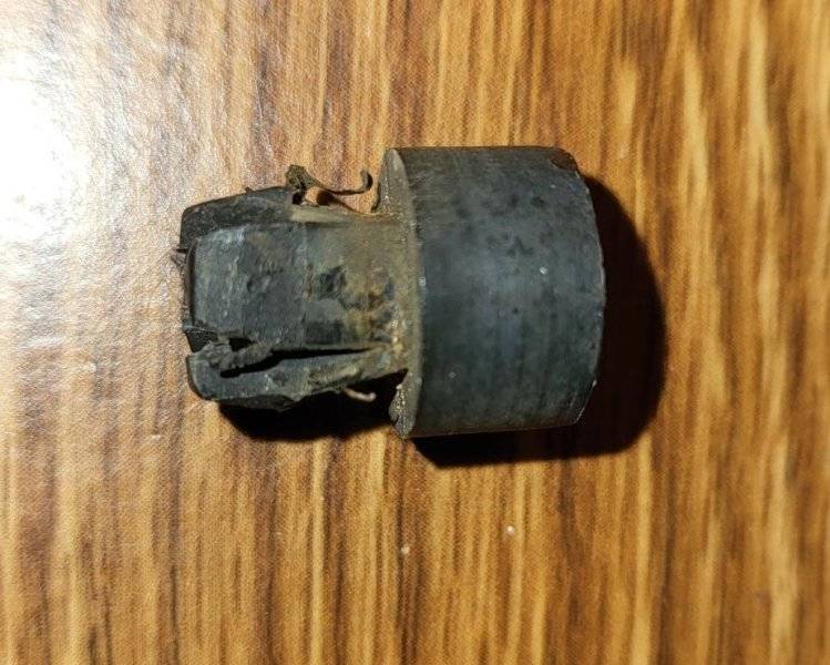

Where do I go searching for the plastic insert that goes in this square hole?
And, what is it actually called?
71Beeper,

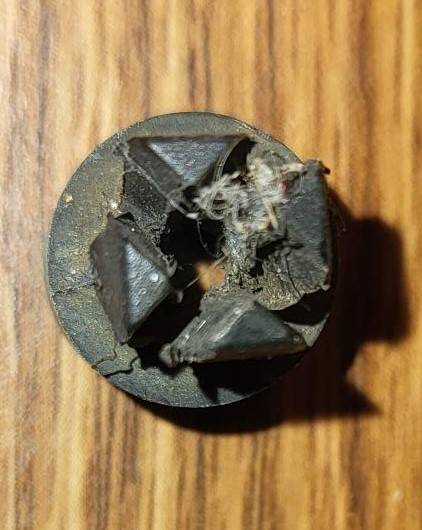

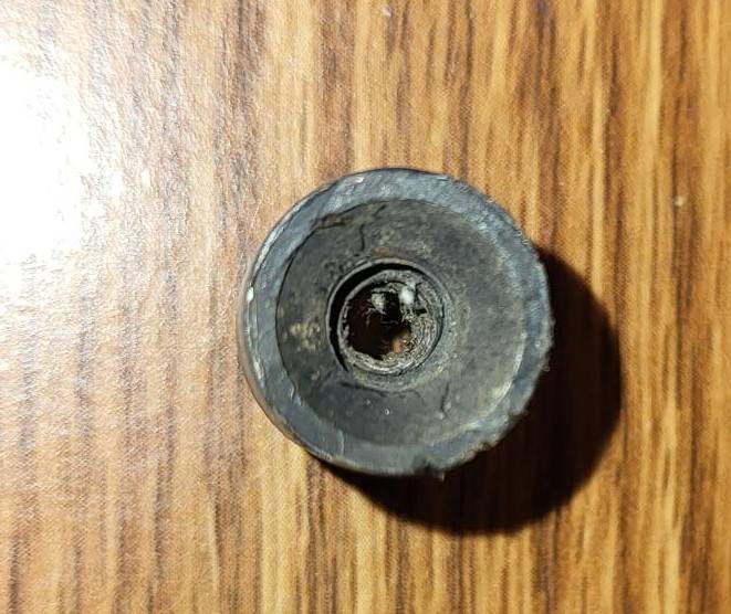

I am in the same dilemma. I attached pics of what they look like. You can see this one is in pretty bad shape I looked at Auveco and the clips and fasteners website under license plate fasteners but no luck.
Any suggestions out there?
Thanks,
GTX 440

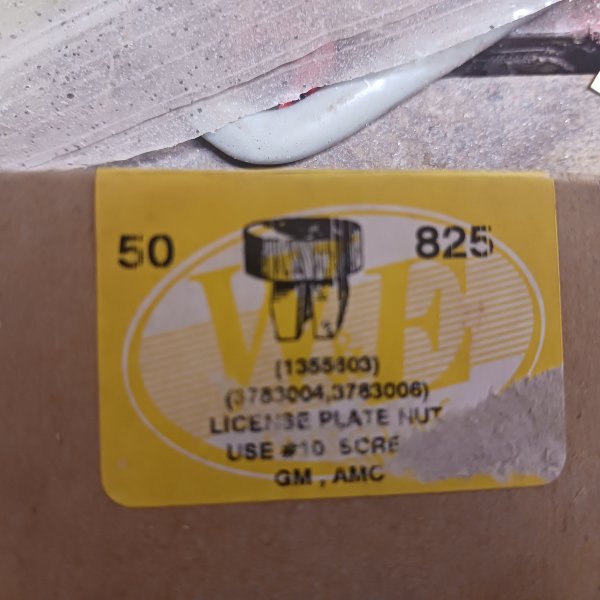

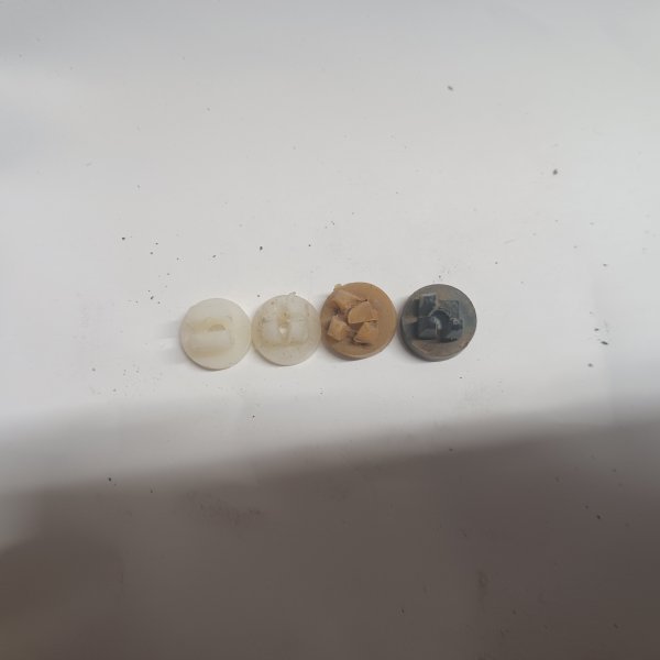

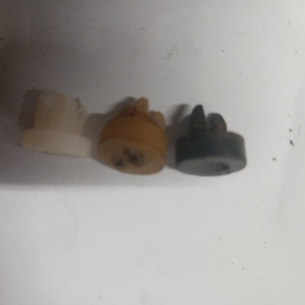

Here's what I ended up using. It has the same shape, just a thinner round part. I used some plastic/nylon washers to space it out to the same thickness. I also used a hacksaw blade to split the part that inserts into metal bracket. A new unsplit one is on the left in first photo. The second one from left in photo shows the square back split with saw blade. The second photo shows difference in round part thickness. The last shows the W&E the inserts came in. I had to buy a box of 50. May work for you.

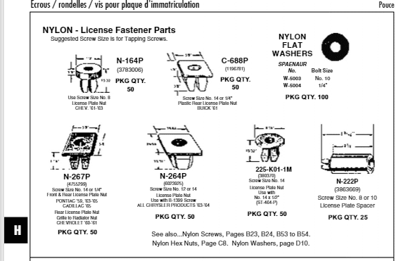

I'm also going to have a look thru Spaenaur's catalogue to see if they have any.
How many do you need? I bought a whole box and only used a few. I have one more Charger to do. Looks like they carry the same thing I have. PM me.
