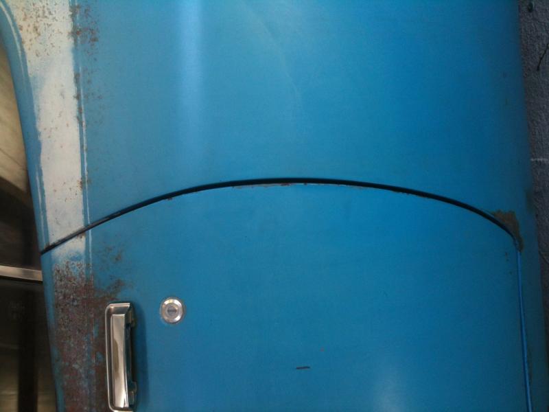

Not factory spec but mine are no more than 1/4" I'm sure. Can measure if you like. Car has never been modified or rebuilt body wise
I measured the gaps on my 72 SSP and they are approximately 3/16", if you want to know exactly the range was from .150" to .190" measuring with dial calipers.
I appreciate the response. 3/16 is close enough to go with that. How about the other gaps, like door to fender, and fenders to hood? Thanks Guys!
All gaps was the same. Again, now that I think of it, the gap should be 3/16"
