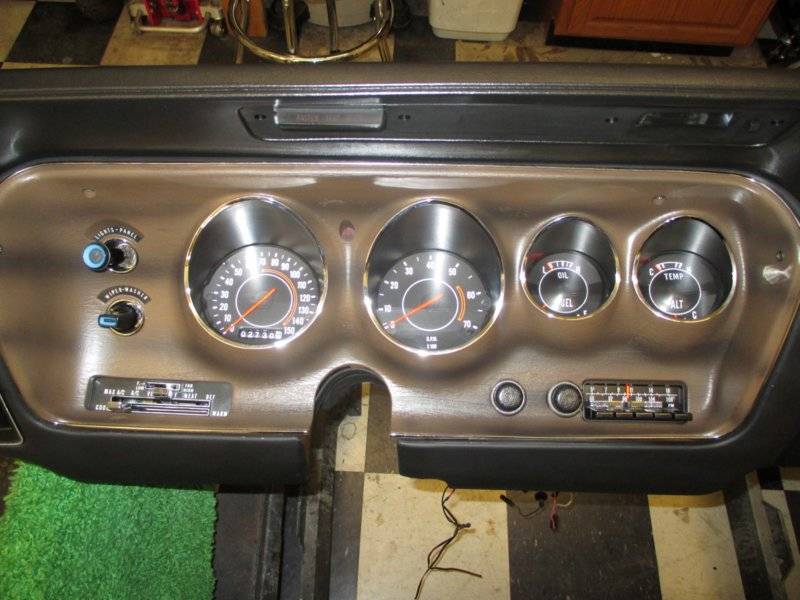

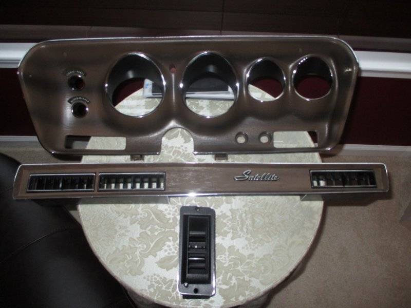

Glen @ GCAR is the best of the best. It will take about 3-4 months so plan ahead. Check the website for pricing or call him you won't be sorry. I have all my dash pieces done by him for years.
Ron
Ron
View attachment 737573 View attachment 737575
Wow - that is exactly what I'm looking for. Your dash looks GREAT!!!!!!!
Thanks for all of the good leads guys!
That dash of RJS's looks nice. One thing I don't care for tho and this is just my opinion so don't hate on me, I think the black thru the dash looks too thin and uniform. On a few of my clusters it almost looks like there's brush strokes in the brown, altho there's brown over spray on the backside. Molotow chrome paint sprayed thru an airbrush looks exactly like chrome when applied on plastic.
That dash of RJS's looks nice. One thing I don't care for tho and this is just my opinion so don't hate on me, I think the black thru the dash looks too thin and uniform. All the original dashes I have the brown is applied over the black and by the looks of all them it was applied with a brush. I can see brush stokes on all of my clusters and dash inserts. Butterscotch71 has an NOS cluster, maybe he will post a picture. Also Molotow chrome paint sprayed thru an airbrush looks exactly like chrome when applied on plastic.
I know what your saying, when I first held it in my hands I scrutinized it too. But have to say once in the car I really forgot all about it. I have another set he did for me a few months back that I'll have to see if I have pictures of and post.
Ron
It's definitely a great looking cluster. I'm sure in the car the black isn't as noticeable.
