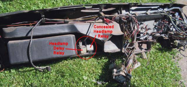

I recently started to replace my dash harness in my 72 rallye. Been noticing missing parts. Which happens to be the hideaway headlight relay and headlight relay.

hideaways relay it's between Ashtray and glovebox, down the dash frame
you can get NOS ( expensive ), repro from chargerspecialties ( not like NOS but still not cheap http://www.chargerspecialties.com/wiring.htm scroll down ), or use a 5 pins bosch relay to make it work too ( need to get a breaker for safety ):
Also maybe can grabb by yourself from some Junkyard around... lot of Mopars got same piece or pretty much similar up to 80s
