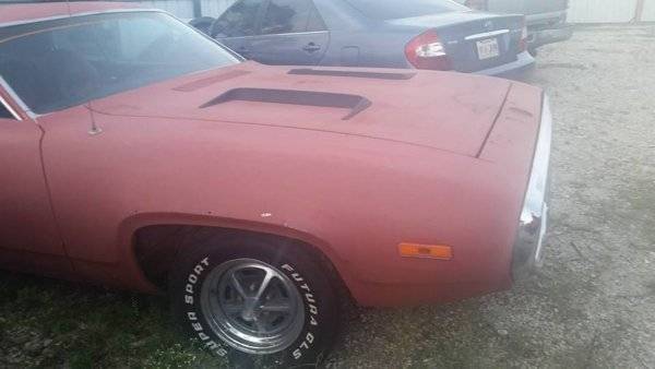

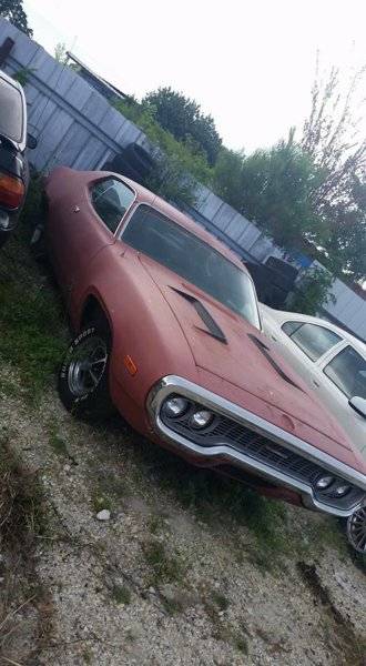

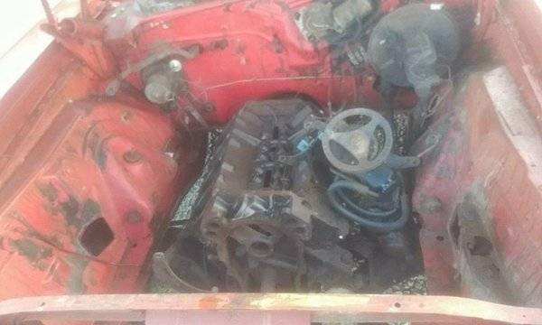

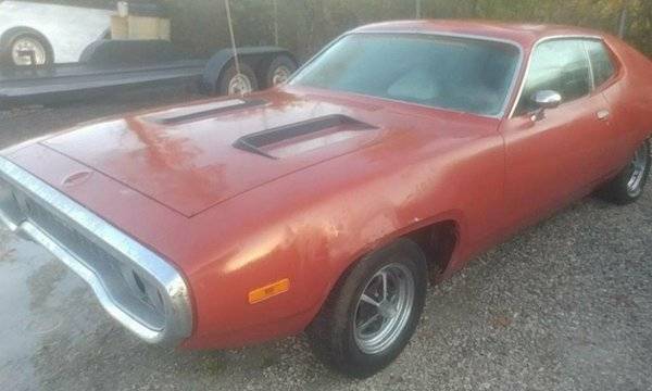

Hey guys new to the forum. i got this beaut for what i thought was a deal for 3500. only have a block (440) and trying to come up with parts I can take from other vehicles (being cheap for now) that could fit into it before i install High performance parts. I want to get it running enough to make it to CA. Friend has a shop that wants to help me on the project.
View attachment 536322 View attachment 536323 View attachment 536324 View attachment 536325
It looks like there's a big block in there already. Is that the original motor? If it's big block, the cheapest way is to stay big block. You can already see the bores with the heads off & it's not too tough to pull the oil pan to check the bearings + you can turn the motor over with a breaker bar to see if it turns. I personally like your idea of putting some rebuilt heads on it to get it to CA & go from there. How confident are you that the brakes/trans/rear are OK now?
The cheapest stock radiators are out of C-bodies & looks like you will need some exhaust manifolds, carb/intake + maybe some brackets and stuff.
Your safest bet is to find a flat bed tow truck & get the car up on a loading dock somewhere and just ship it to California & un-load it with a flat bed there....no worries.
Cool 72
good luck & happy Moparing
