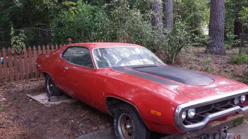

1972 RR GTX, numbers matching U code, 4-speed, Dana 60. My uncle became second owner in 1975, beat the hell out of it, and seized the motor with 49,000 miles on it in the winter of 1977 due to lack of oil. He removed the drivetrain, brakes, and gas tank with the hopes of rebuilding the motor shortly thereafter. As you can guess, life got in the way, and he passed 5 years ago, which is when I took possession. The car was mostly indoors, but spend some time in the elements - not to mention that it was driven in the winters of upstate New York on salty roads. There were also some critters and nests inside it, which helped reinforce the decision to strip it to the bone. So that brings me here:

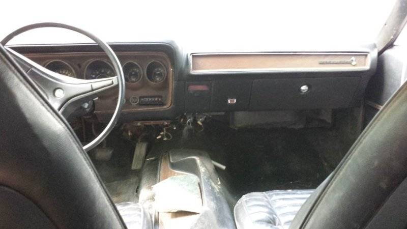

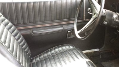

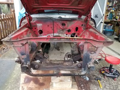

This is how I received the car. The interior was almost pristine - it felt like you could just drive away if there was a shifter (and motor) sticking out. The dome light, key buzzer, wipers, etc. all worked. Initially I was going to poor man blast the bottom, rebuild the engine, suspension, brakes, fuel, and try to get it running. But I was strongly advised to strip it all the way down (and replace the electrical harnesses), and I am very glad I did. There were nests behind the dash, which caused rust in the cowl, chewed the heater box fan, and chewed a bunch of wires. After months and years of going to shows and gathering information online, I decided to do it right. Or at least more right than plan number 1.

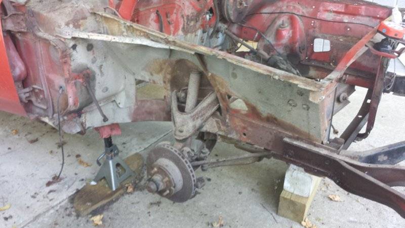

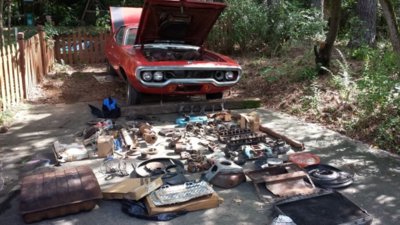

So I spent a bunch of last summer completely stripping out the interior, brake/fuel lines, and remaining engine compartment items.

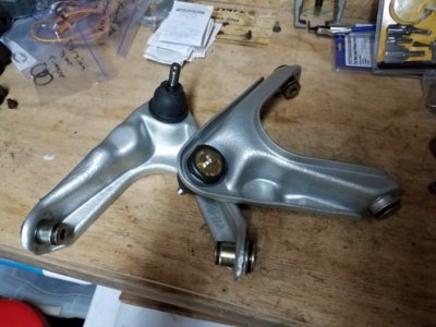

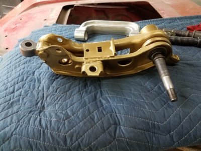

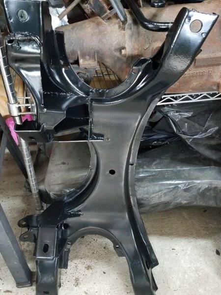

I started working on the suspension. With the help of that B-body book, this forum, and lots of other people, I think I am on the right track. I got the main parts powder coated, and replaced all of the UCA and LCA bushings and ball joints. I did this in parallel with my research in trying to find a good sequence of events to get it cleaned up, metal work, and body/paint. My thinking is that I want to do as much myself as possible, and obviously save on costs as much as possible. I won't be dropping it off at any of the $100/hour resto shops around town, in other words. I have also decided that there are several things I am absolutely going to outsource, because I don't trust myself to learn on the fly with this car - blasting the frame, metalwork, body, paint, and ultimately the engine rebuild. Everything else I am going to try and tackle - electrical harnesses, fuel system, brakes, suspension, interior, seat rebuilds, and maybe rebuild the dash.

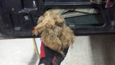

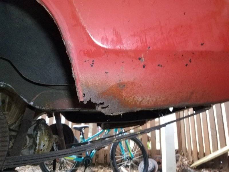

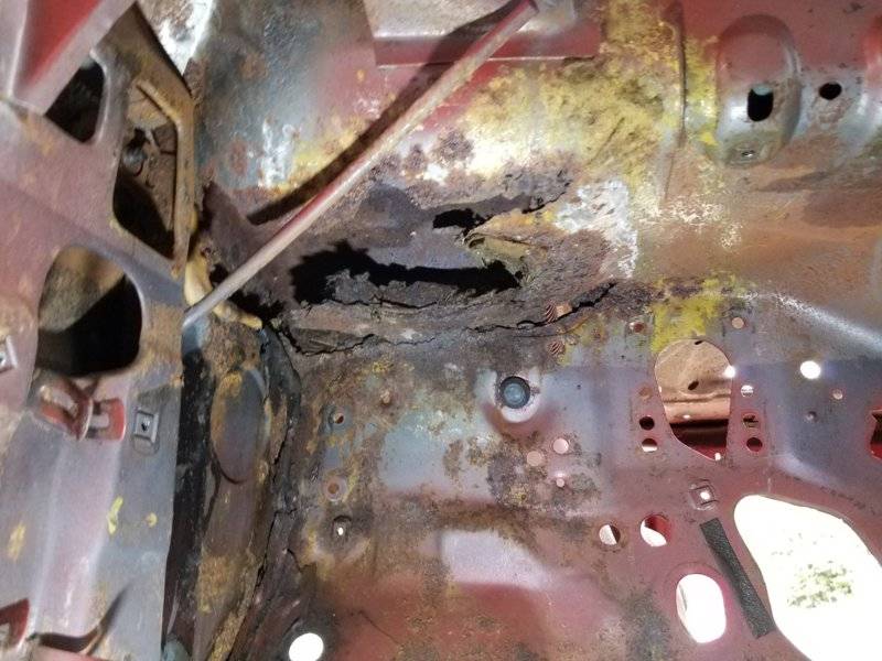

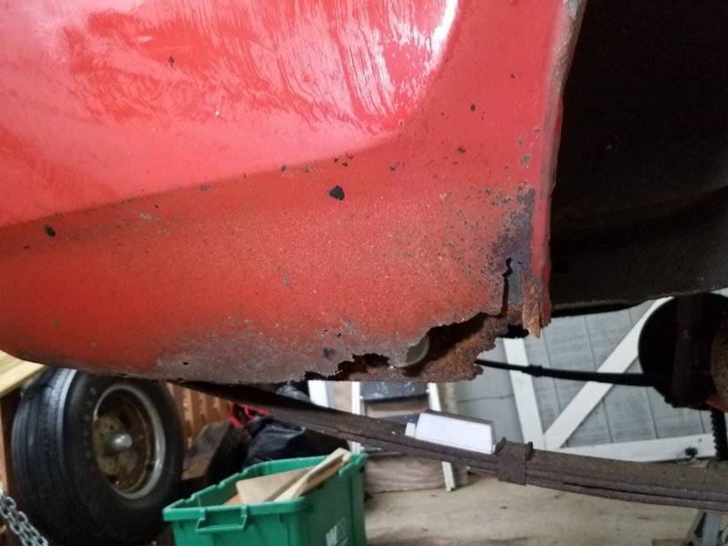

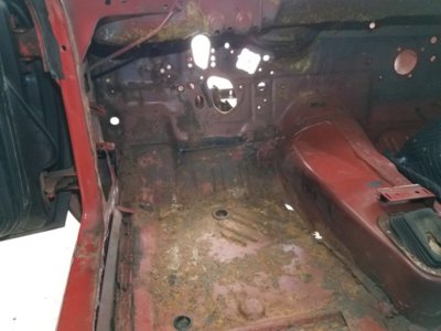

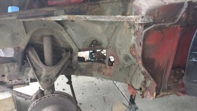

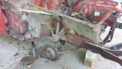

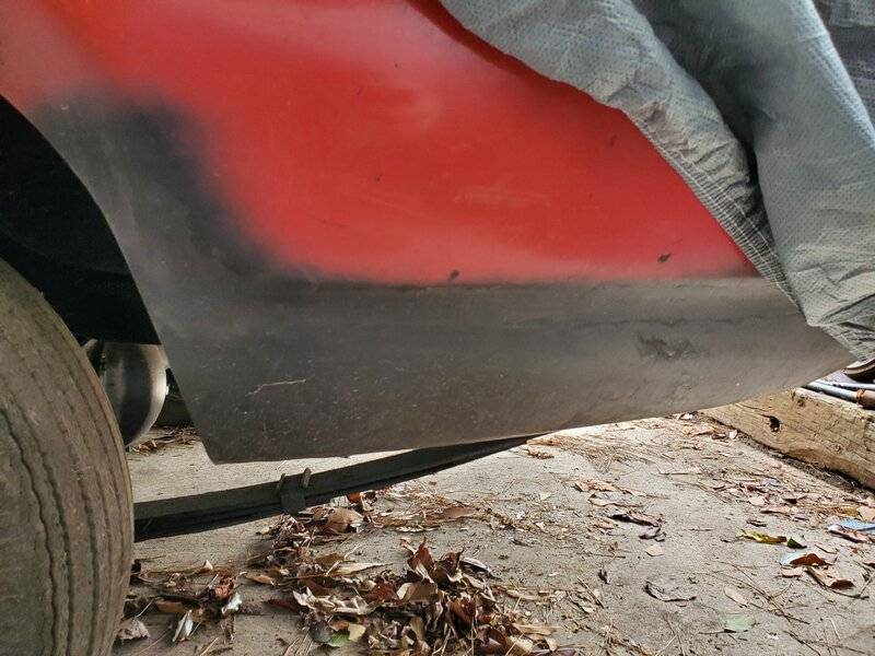

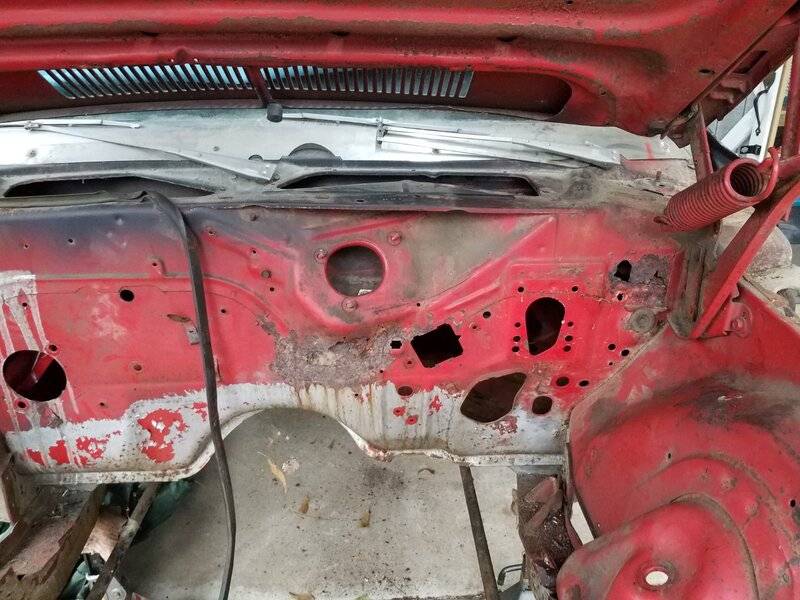

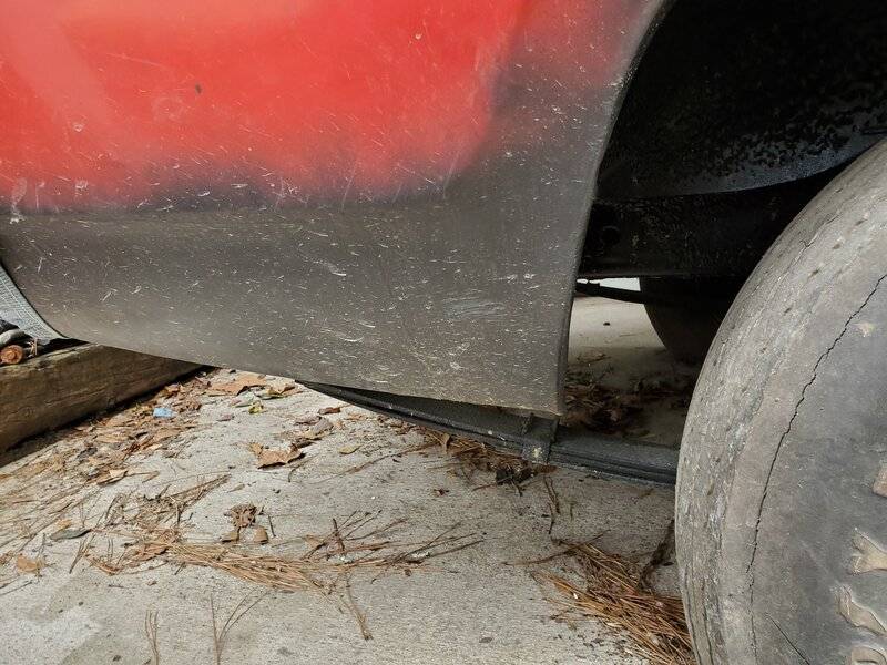

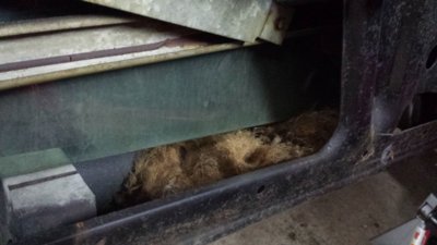

Here are probably the worst parts in terms of rust - all 4 quarters, drivers side floorboard, a hole in the firewall, and that large chunk in the cowl caused by a huge next sitting there for who knows how long.

Oh, one more thing is still on the car - the wipers and linkage thing behind the firewall/cowl. I read the service manual, searched youtube, and stuck my head up to the cowl hole and can't figure out how to remove them. Doesn't seem to be any bolts, screws or anything holding the wipers on. Do they just pop off with the right tool?

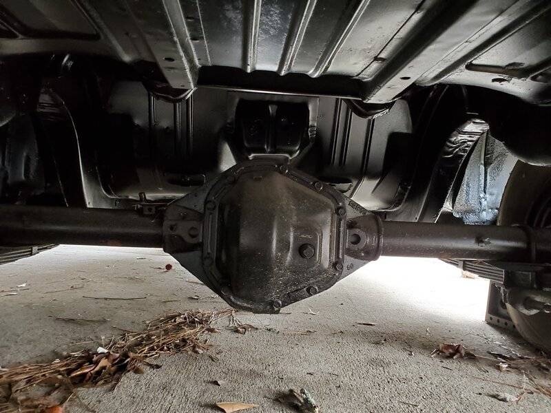

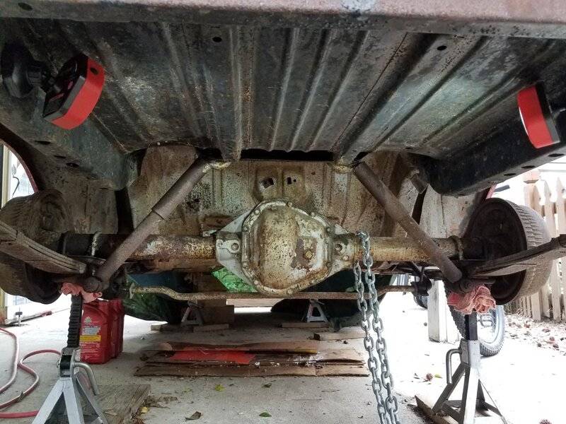

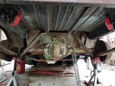

Is it OK to get the Dana 60 and leaf springs blasted and primed while still attached to the car? I assume we can mask off the drum/axles?
I talked to the paint guy, he plans on using something called direct-to-metal (DTM) as the primer. He said it is sort of acid etcher and epoxy sealer all in one. Its a bit harder to sand later, but he said its one coat and done as opposed to doing the etch then urethane epoxy coat after that.

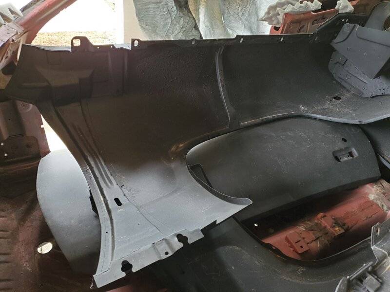

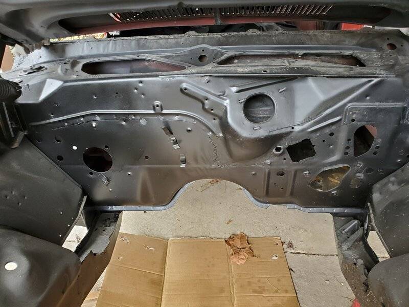

Haven't updated this thread in over a year and a half, so here goes. We just completed a fairly major add on to our house, and I am putting the finishing touches on a 36'x22' detached shop/garage I built, so this project has sat since late 2019.

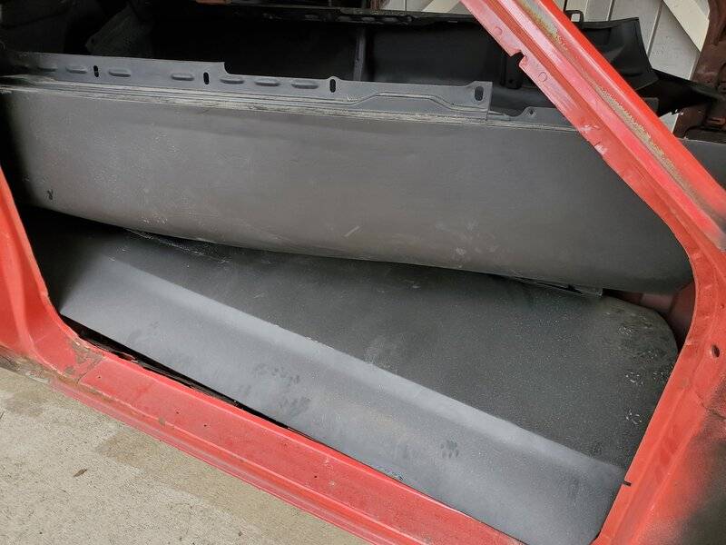

The plans from above changed a bit, and I went straight to the metal work guy. He seems to have done a kick *** job at getting rid of all of the rust - new trunk extensions, quarter patches, fixed the bottom of both doors, frame rust, fender patches, wiper motor rust spot on firewall, and rusted out part on the cowl. Interestingly, we noticed that the right fender was blue on the inside, along with a dent to the frame behind it, and bondo/rust popping up on the passenger door. The only thing we could figure is that before my uncle bought it in 1975, someone wrecked the front right of the car. Seems they put in an aftermarket fender, didn't reshape the frame behind it, and did a 1970s bondo and paint job on the door. He wound up getting a whole new used fender for me, because he said the old one was so messed up and smashed in that it was not even the correct length.
Lastly, they sandblasted all of the removable parts and the bottom of the car and then primed the bottom. It seems to have made great progress, so I believe paint and body are next.

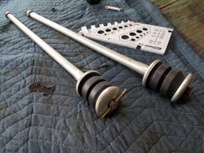

20190217_102531.jpg 20210302_124643.jpg 20190217_105151.jpg 20190217_105254.jpg 20210302_124605.jpg 20210302_124624.jpg Rear Sway Bar Parts - On Car (1).jpg 20210302_124546.jpg 20210302_124457.jpg 20210302_124527.jpg

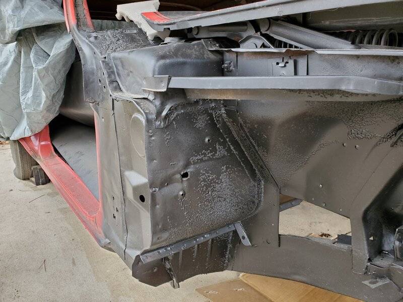

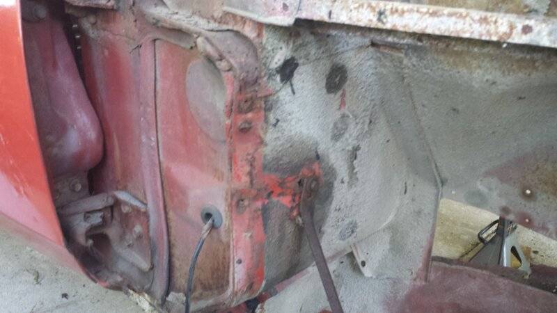

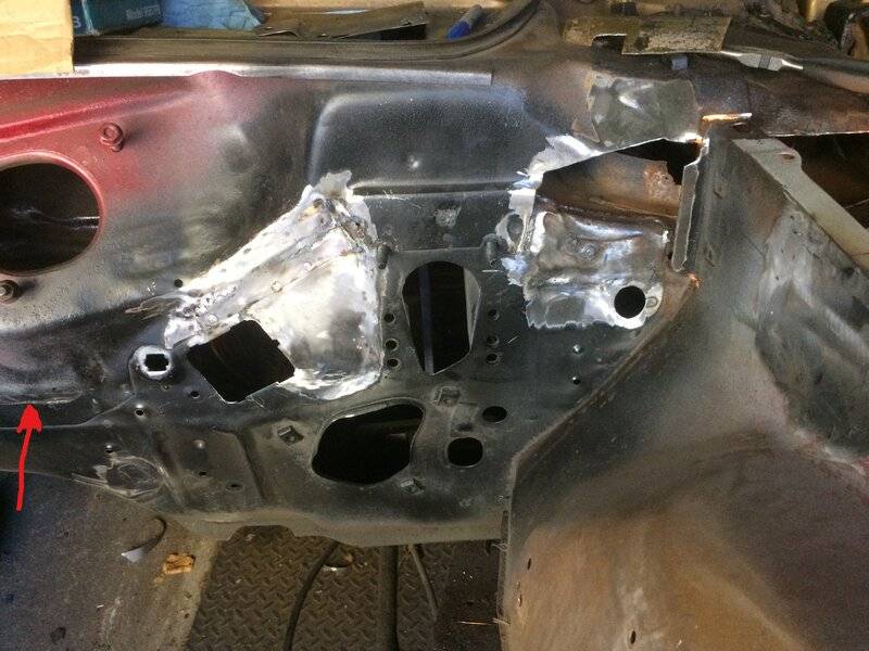

Here are those frame/firewall areas right behind each fender (not sure what we call these spots). The passenger side one was messed up pretty bad, and the driver side was rusted out a little. Not sure if these are right now, or if they are going to give me trouble getting the fenders back on.
I have a paint and body guy coming out next week to look at the car and give me some prices. He was saying that some people paint the trunk and engine bay black. I told him it was my understanding that they were frame color. I want this thing to look as close to how it looked when it left the factory, so I am trying to figure out what to tell him I want. Also not sure about the undercoating: from what I have gathered, we think the dealer or previous owner tried to spray paint the bottom of the car, along with the Dana and the bottom firewall at the transmission hump, in some sort of metallic or silver paint. That's not factory paint, right? What should I tell him I want in the engine bay and underneath to make it as close to factory as possible? Black truck liner type stuff on the underside and inner fenders? This guy sounds like he knows what he is doing, but he doesn't sound like a Mopar guy. He said he just did a 72 Mustang, but hadn't done many mopars.
