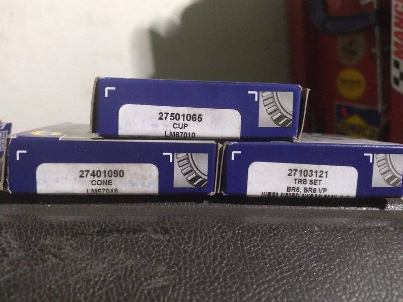

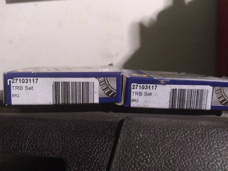

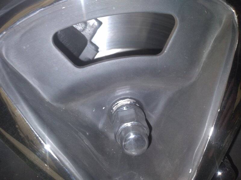

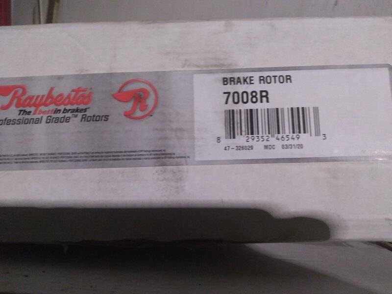

Just did mine on the 71 this past weekend. Factory pwr disc brake car.. Here are the rotors from RockAuto. Pretty much the same part # as Classic Industries and as a set I have NOS from the 90's. Here are pics of disc and bearing part #'s. Couldn't remember where all the boxes went so here is what I have left. The 3 boxes pictured were 1 separate race, 1 bearing and then one had the bearing and race together as it's own part #. Those are Napa bearings made in Spain. Napa has the seals also. Should get you goin in the right direction. I have an extra set of disc's if you can't find any. Good luck!
Rockauto shows 3 choices the Cenrtric # 12163022 is out of stock but use that # and look around. 10.90 size. What type calipers do you have? Slider or pin type? To go to the 11.75 rotor you will need the brackets, again slider or pin. IIRC Dr Diff has the sliders but the pins are hard to find and big $$$. The 11.75 probably wont fit 14in wheels.
Your stock rotors are not 10 ". They are 10.97". As stated above they are available.

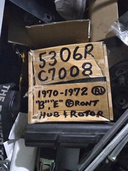

These are from this guy. 1pc replacement for 2pc rotor and hub assembly. Has all sorts of NOS parts
As JG71B points out, if you want *** N.O.S. *** U.S.A. made parts --- your car would much prefer them --- andnI have EVERYTHING indicated above ^^^^ including
