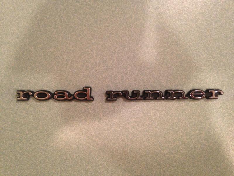

I have a 1972 RR clone and I need to apply the Roadrunner emblems to the rear quarter below the rear side windows, the emblems are the adhesive type and I purchased a NOS set but the adhesive has dried out and there is NO way they will stick, I shelled out good money for this NOS set that are now completely useless, do they make new adhesive for these ? do they make new emblems that come with good strong adhesive ?? I need help please. what the hell do I do ?

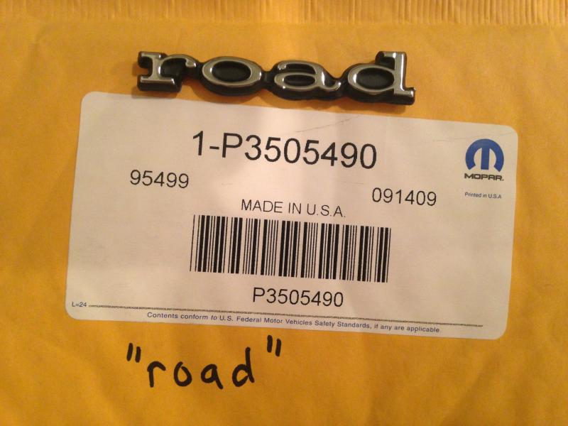

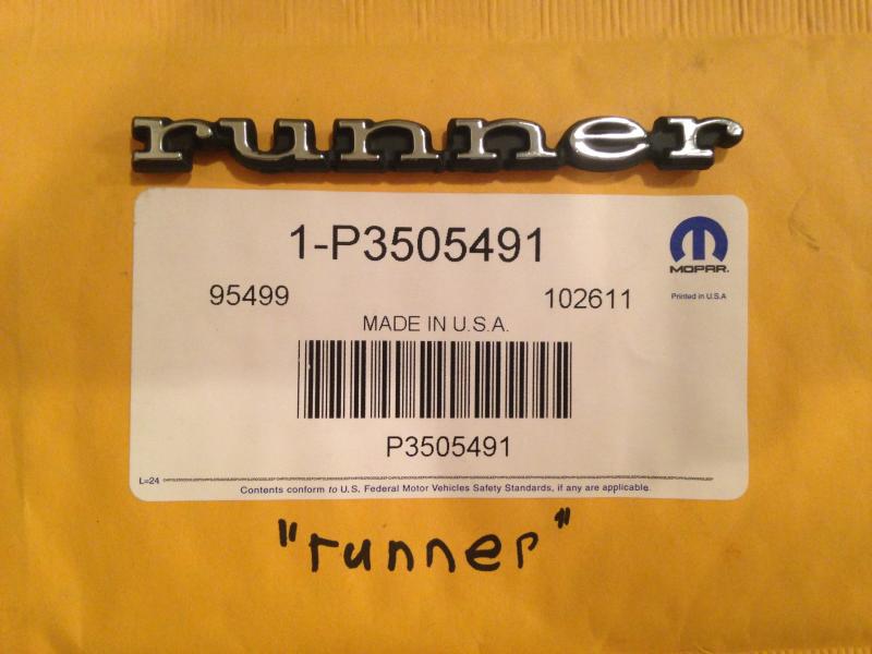

They are still a available from Ma Mopar. Here is my set. Ordered them from the local Dodge dealership.
Thanks for that info, I went to my Dodge dealership and ordered a nice fresh set and they went on nice ! they look perfect !

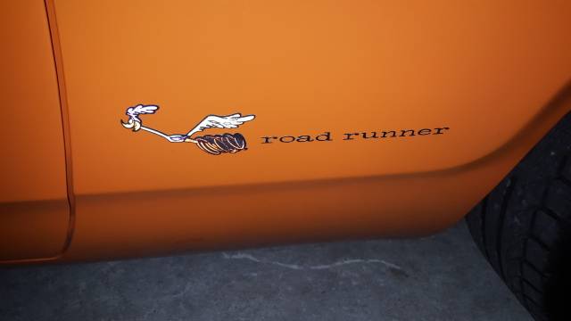

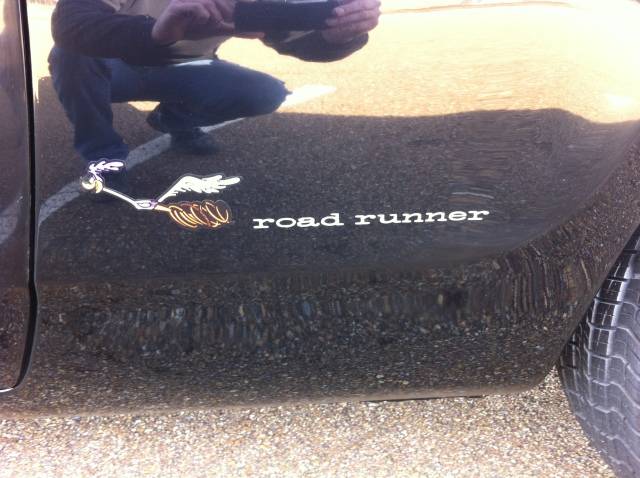

I'm not all that worried about originality. Having said that, I had a friend print me up some decals out of 3M chrome material. Seeing that the bird is a decal, to me it's a cleaner look if the wording is also a decal. They are the same size and font as the emblems and most people wouldn't even realize that's not how it was done originally. Costs about 1/4 the price of the emblems as well.
This one I put them too low, but you get the idea.
Just another option, unless you are going for originality.
